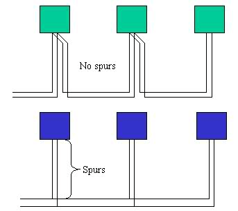

Spur wiring?
RS-485 is intended to be daisy chain wired: device to device to device.
RS-485 doesn't like spurs.  Spurs are lengths of cable wire that are not direct connections to the instrument/device wiring terminals, but lead wiring from main line at a terminal strip/junction block to a device.   Reflections are created in spurs which induce errors.
The image below shows the difference between spur and no spur wiring.
Are your devices wired with spur wiring, or is the a cable routed to the device where it connects and cabling then proceeds to the next device?

RE: Modbus Communications
The wiring diagram I have shows that the two separate burners are to be wired completely independently.  Which I believe is what Dan refers to as a spur, I know it as a stub.
I was just able to confirm that our units are wired in the spur fashion.
I also tried using a separate wire for the ground wiring, but that did not seem to change anything.  Some of the communications seemed to work, but others didn't, and it seemed to be intermittent data transfer again.
Tomorrow I will try new wire and I will also attempt to daisy chain it to see if that helps.
macmet
You must eliminate the spur wiring configuration and wire as shown with 'no spurs' in above drawing.
Also you must keep not mix the pairs. Meaning inside the cable the wires are twisted in pairs. If one conductor from a pair and another single conductor from another pair is used as a TX or RX port the system will not function.
Also each RS485 device will likely have a terminator resistor option or an included resistor to be attached at the terminals of each RX or TX pair. The rule is that if a TX or RX line lands on a terminal and another pair leave from it then the termination resistor should NOT be applied.  If only a single RX or TX line lands there the termination resistor should be applied.
In the previous drawing from danw2 the termination resistor is only installed on the last device on the right.
And also minimize the length of lead outside the overall cable.
