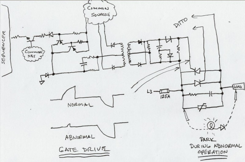

This thing is thrashing me so thanks for any suggestions.
Bill rolling it didn't seem to change anything.
It only malfunctions for about 15 seconds every hour or so.
This is preventing me from studying the problem while it occurs.
What I have been able to see is that the currents go way out of balance. Like from 33A,33A,33A to maybe 22A, 33A, 43A during an episode.
I made a half-wave test lamp and discovered that it extinguishes completely during a fit on channel three only.  (See sketch)
I was also able to catch the gate drive as seen across the SCRs during an event. (See sketch)
First: Do you agree that for the lamp to go out, as hooked up, it would mean that SCR was stuck ON during a period it would normally be off?
And secondly any suggestions as to what component in the drive circuitry might cause this come-and-go problem?
Please note my sketch shows the drive hardware on probably the opposite channel that's misbehaving.

RE: Phase controller problem
Here's a theory:
This is looking like a stuck-on issue.  But the SCRs are fine.
The abnormal drive picture doesn't look like an extended trigger pulse.
This controller feeds a transformer.
The problem ONLY occurs at power settings above 50%.
I am suspecting the issue is a dVdt problem - failure to commutate.  This means the snubber is not getting it done.  Perhaps the MOV is worn out?
Any agreement here?
Keith Cress
Don't forget that 'stuck on' is in reality premature triggering. It could be failure to recover blocking capability but after a half-cycle of reverse bias that would be really unusual.
Could you have noise getting in to the gate drive electronics further back in the light current section of the controller, perhaps as a result of switching on a different phase? That might explain why the problem only occurs above a certain setting - a combination of the firing delay angle of the other phase being suitable to cause false triggering of the pair you're having problems with, and possibly a more powerful interfering source due to higher current.
Can you have a look to see if the false triggering happens to coincide with switching on a different phase?
