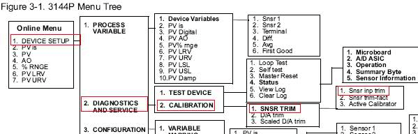

I have a 3144P, 0-150deg F, 4-20ma output.   Using a test device to simulate RTD input to the transmitter, I have 0F and 4ma output and at 150F i have 20ma output and it is read correctly on my PLC.  This is all good, the problem lies with this, when I put a calibrated temp probe in the thermowell next to the transmitter to verify the temp my test probe reads 1.2 degrees more than the transmitter.  I need to calibrate the transmitter or adjust the transmitter to read the correct temperature as the test probe, within .5 degrees.  I have not done this in a while so am rusty at this, need a refresher.  Is the RTD bad?

The Sensor Trim command allows the user to digitally alter the transmitter's interpretation of the input signal as shown in Figure 3-6 on page 3-28. The sensor trim command trims, in engineering (°F, °C, °R, K) or raw (Ω, mV)units, the combined sensor and transmitter system to a site standard using a
known temperature source.
pg 60, Rosemount 3144P Temperature Transmitter manual
http://www2.emersonprocess.com/siteadmincenter/PM%20Rosemount%20Documents/00809-0100-4021.pdf
Navigation sensor trim is 1 > 2 > 2 > 1 > 1 according to the menu structure:

Another question, the manual speaks of upper and lower trim, does this mean 0 and 150f.   Getting confused again.   So do I have to do what the previous post says too?  Basically I want to know how to make it read the same as the test probe, in simple terms.
