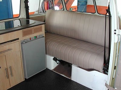

Well VW produce several different type of vans and a member wishes to convert their bulkhead panel van to a swivel seat van by removing the bulkhead and wonders what, if any, additional strengthening should be added.
To start the debate these where the models produced by VW and the bulkhead/strengthening used.
1. Panel van, bulk head side to side from B-pillars, raised rolled floor side to side under seats.
2. Walkthrough, 2 tubs around the rear of the front seats, raised floor cut in the middle and lower section added to from a walk-through area.
3. Swivel seat, same as above with the tubs cut right back to just form triangular support at the b-post.
4. Flip-seat, same as above with the triangular upright supports removed.

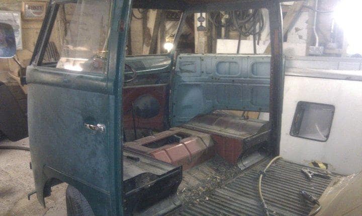

Below is a bulkhead model with the bulkhead cut out
At the B-post area is a metal hoop running up the b-post, across the roof and under the floor is one of the main chassis section cross members.
So if the bulk head of a Panel was cut out you would be left with 4(a flip-seat) model, how much weaker is this and did the original bulkhead offer any protection from a side impact or is it just stopping goods in the back of the van flying forward and hitting the driver?

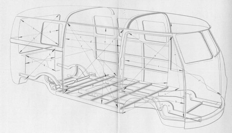

Here is a schematic of the van frame
[img = http://www.vintagebus.com/techinfo/dim1.jpg]

Under the floor where the roll cage sits is one of the two main chassis cross struts in the van, this is where the outriggers and jacking points are located so I think it is pretty strong, but could be re-enforced if people think that is required?
As for the X-cross between the B-posts I am happy this will not get in the way too much when walking from front to back and will allow the seats to swivel into the back and be useful without bars in your face! but if they are offering no additional later support and protection (?) then I would prefer to not have them, smaller triangular struts could be used instead which would also not interfere with swivel seats. (I have added these in red here)
It is possible to brace across the door (again shown in red) without it getting in the way of being able to get in and out of the van easily. Would this add significant strength improvements to the cage? Or is it just to protect against side impacts?
