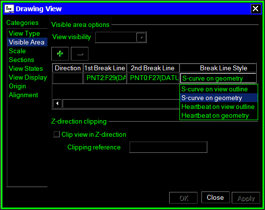

Hi Everyone,
  I have a ortho or right side view & I would like to create a broken view to show the Engine Center Axis.
  How can I do this to & have an 'S' style broken view?  Currently, my engine center axis is horizontal datum. What do I need to do make it appear as a center line in the drafting side?
Using ProE 4.0

To get your axis to show as centerline display it as a datum axis.
Where to find S-curve setting?
It's the column all the way at the right hand side of the Visible Area category in view properties.
Direction|1st Break|2nd Break|Break Line Style
The available options on list are
Straight
Sketch
S-curve on view outline
S-curve on geometry
Heatbeat on view outline
Heatbeat on geometry

Hi Michael & Others,
  I managed to make an S shape breakview, but it's not quite what I wanted.
  Seems like the only way to create a breakview is to select two horizontal or vertical lines/edges from the part.  This appears to be the approximate gap difference.
  In this instance, I have an engine center line or axis that I'm trying to present.  The only areas & I need to gap is the empty radial distance between the engine axis & bottom of part.
  How can I get this area?
  Do I need to fudge in some lines in this area or do I need to have 2 separate views, then break one of those views?
 What are your suggestions?
