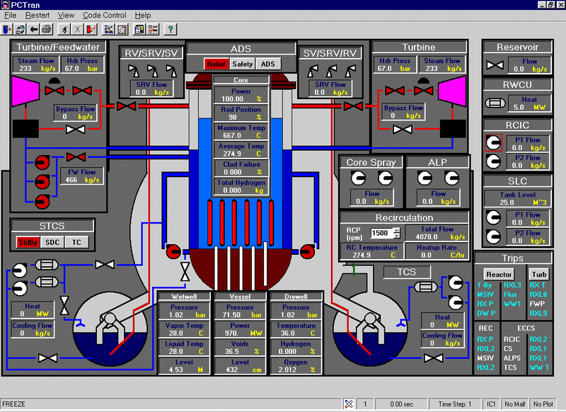

Quote (rcchap):
I know that there are advanced digital technologies out there, but they are rarely used in the nuclear industry, and would definitely not be used for reactor control.
I found this in the internet!

Link?
RE: hindsight- how to avoid repeat of Fukushima
Uhuh, sorry. Missed to add the link.
Google
Or Here

What you have found is a simulation program.  This seems to be a simple one.  Most (if not all) US reactors will have a full scale simulator room that mimics the actual control room and is controlled by computers that are programmed to mimic plant operation.  These are used for operator training and NRC license qualification.
So, of course, digital technologies are used for simulators and plant process monitoring systems and to perform calculations.  My statement is still true.  This type of digital system would not be used to control any actual plant equipment, at least on the existing US nuclear fleet.
The newer generation of plants will probably have more digital controls, but to what extent I do not know.
