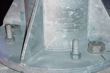

Hi
I was looking for a reference to determine the Stress exerted on column face by base plate stiffener, the base plate stiffener that I'm talking about is similar to this:
http://www.fhwa.dot.gov/bridge/images/sign36.jpg
I have only found an equation in "Design of Monopole bases" page 77. But the result is relatively small around 30 N/mm^2.
The problem is that when comparing the hand calculation with the Ansys FE model I'm getting larger stresses and ends up with the upper edge of the stiffener connected to column face is overstressed as well as the column surface at that point.
For the constrains in the Ansys I have tried both cases of making stiffener connected to the column as an assembly and then put "Bonded" contact constraint and tried to make the column and stiffeners as one part then connect them to the base plate, but in both cases I'm getting what is stated above.
So either the hand calculation is not conservative, or the Ansys analysis is not giving accurate values.
Any suggestions?

You'd expect the end of the rib stiffener to have a very high stress as it acts like a point restraint (or point load) on the column. You'd probably see the same thing around the holding down bolts (depending on how you modelled the restraints there). These are peak stresses rather than average membrane/bending stresses that your hand calculation may give. These peak stresses would be checked against fatigue design curves if the loading was cyclic. If you just have a static load then you'd need to look at the stress distribution in your model around these peaks, and remove that peak stress component to give you the nominal stresses in that region. The nominal stresses would be compared against your design stress limits, related to the yield stress.

Increase the height and thickness of the stiffener....spread the load a bit.
RE: Stress exerted on pipe column face by base plate stiffener???
Another way is to prefabricate the stiffeners and base plate together, with the stiffeners crossed, and slot the assembly into the tube.  Takes away a lot of the discontinuity.
Just curious...in the photo, why the large bolt adjacent to the stiffener, then another smaller bolt which looks to be centred between the stiffeners?

Maybe these are combination of holding down (anchor) bolts and ordinary bolts.
