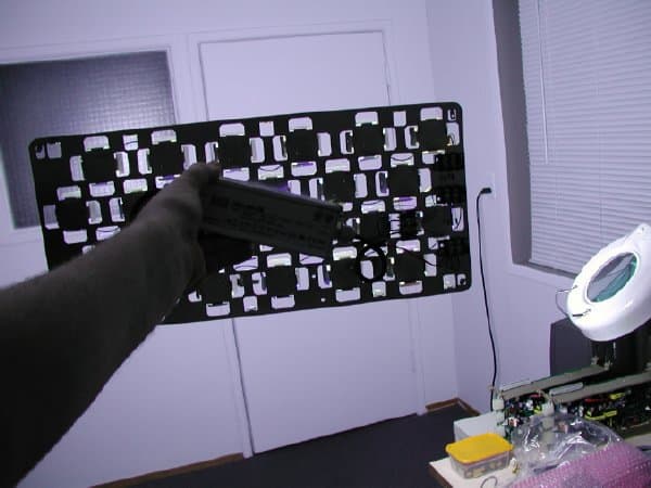

For years we've lit our living room with MH which has an excellent CRI over 90.  That burned out a few weeks ago so I just built this:
It's twenty four LEDs run by a current controller.  That shot doesn't begin to convey the photon flux spewing out of that thing.  It's about 4x the impact expressed here in this picture.
