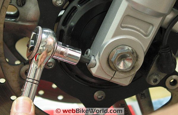

My attempt at a first cut would be to consider it half a "riser clamp"
 http://www.pipingtech.com/products/ptpcat/support/clamp/fig90.htm
Note for full clamping force the clamp can not "bottom" on the structural steel after tightening.
http://www.webbikeworld.com/Motorcycle-tires/avon-storm/fjr-1300-front-pinch-bolts.jpg
