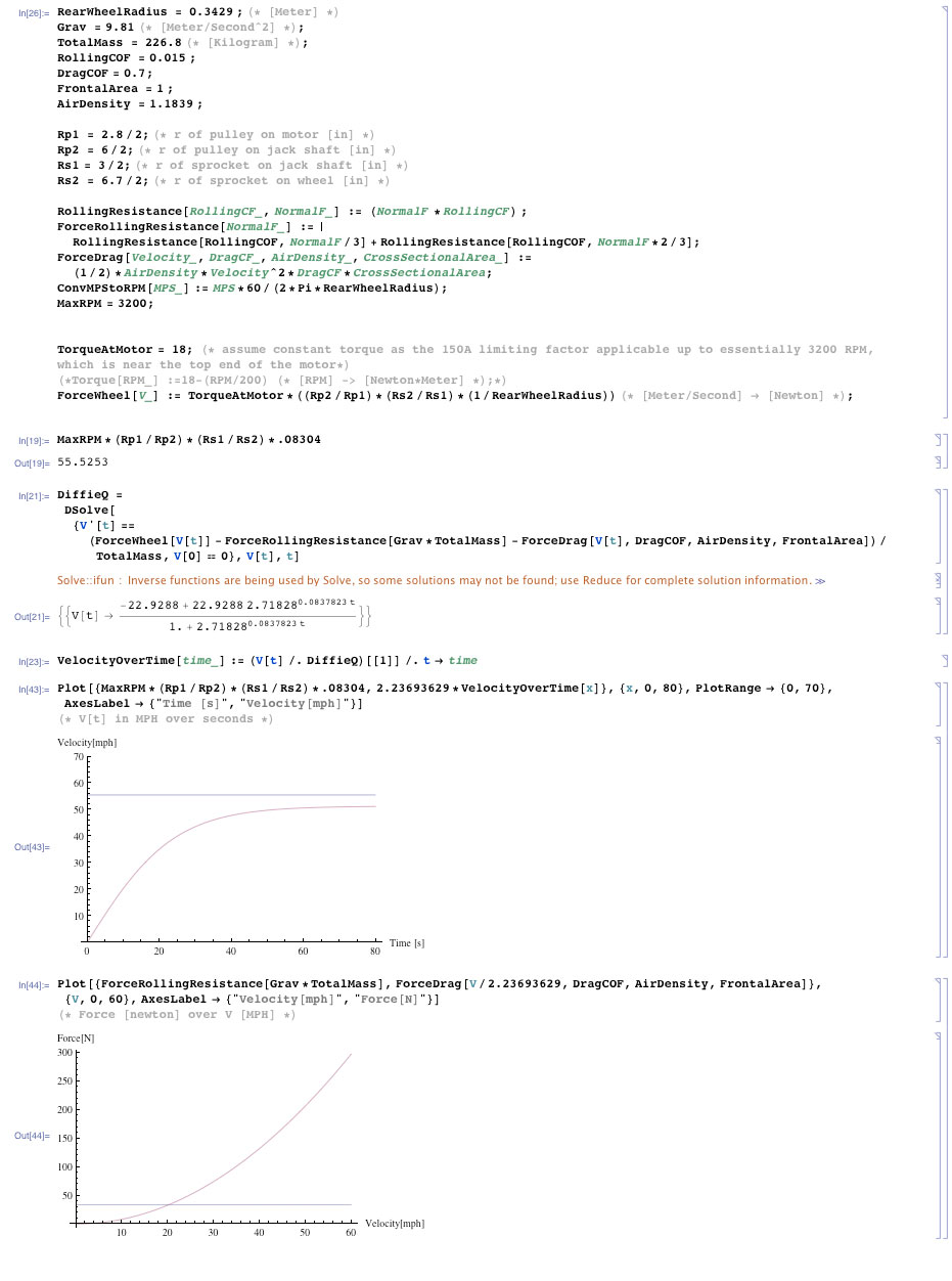

In terms of my modeling situation, the approach I am taking for the grander scope is to solve the differential equation for velocity at a given time using the following equations.
Frr = force of rolling resistance
Fdrag = force of drag as a function of velocity
Fw = traction force at the wheels based on the torque the motor can put out at as a function of velocity
m = mass
(dV/dt) = (Fw(V) - Fdrag(V^2) - Frr) / m
Fw is based off of the current velocity of the vehicle and is the reason I am trying to establish this baseline torque curve for the motor as the torque from the motor is convertible to a force at the wheel based on gearing and wheel size.
The differential equation for the current drawn (I) relies on the back EMF being able to be wrote as a function of velocity, but the velocity differential equation can't be solved till the current is known.  Thus I seem to be left with the option to define a velocity over time function and solve the differential equation for the current, which would make the efforts of solving all of this pointless if I am defining it initially.  Is this all correct, or have I made a mistake?

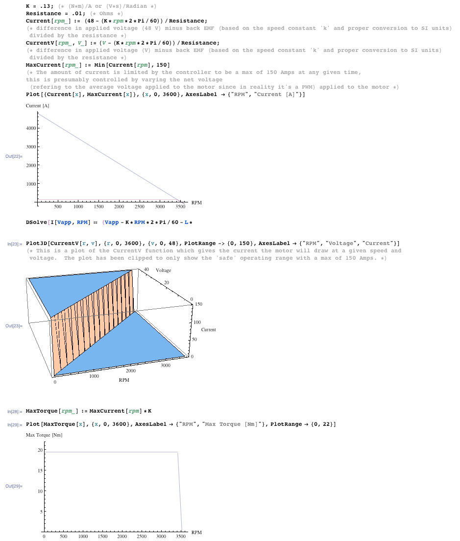

After reviewing the post by waross, a few books and playing with the equations, I think I have a solid understanding of the dynamics in a transient situation. While the difference in applied voltage (max 48v) and back EMF will draw current far higher than within the ratings of the motor when at low speeds, the controller will limit the applied voltage (a bit misleading since it's doing it through PWM) so that we don't surpass our max rated torque. The primary limiting factor in terms of our motor is the max rated continuous current of 150A and thus the primary limiting factor in terms of max torque output.  The 150A threshold covers nearly the entire operating speed range of the motor.  Thus, I assume the controller varies the voltage applied to the motor so that when the pedal is floored, max rated current (150A) is drawn by the motor over a range of speeds in a way that is proportional to the back EMF at the current operating speed.  This only occurs when you are trying to accelerate as fast as possible from a standstill.  Thus this eliminates the aforementioned issues of defining the back EMF as a function of velocity and the differential of current with respect to time (becomes 0) if the current is going to be limited in most situations by the 150A threshold.  While there is technically some differential of time in the feedback loop of the controller varying the voltage and everything that is changing and thus the current in reality is varying slightly, from my understanding these variations would be nearly incalculable for a real lie situation with out knowing the exact way the proprietary controller does this.  Is this a correct assumption or a over simplification?
I played with this a bit in mathematica, which can be seen in the attached image and wrote up the following description http://entplex.org/forums/MotorCurrentTorque.jpg
When starting at a stand still, the controller applies a low voltage to the motor so that the current doesn't excede the rated 150 amps.  Under a situation where maximum acceleration is desired, the voltage is increased slowly as the velocity of the vehicle increases, resulting in a continuos draw of 150A over a range of speeds.  Since the torque that a motor is applying is directly proportional to the current I, a continuos current of 150A mean that the torque in this range is continuos, no?  Eventually a point is reached where the current drawn is no longer constrained by the max rated current of the motor and the full applied voltage is neared, thus the current decreases due to the difference between the applied voltage and back EMF being very small.  beyond this point, the modeling situation becomes far more complex and the assumption of being able to draw the max rated current goes out the door.

"Fw is based off of the current velocity of the vehicle and is the reason I am trying to establish"
No, you are overcomplicating it
Fw= k*I
where k includes Kt and gear ratios and wheel sizing.
 you are missing coulomb friction and maybe some viscous friction from force equation
You have 2  equations which must be solved.
first solve
1)M*sv+k2*v^2+K3*v+k4=k5*I I=150
for v
while testing
2) I=(V-k1*v)/(R) for I>150 I
as soon as
I<150
you solve the coupled pair
2)V=(sL+R)*I+k1*v)
L-winding inductance
s=d/dt
V=voltage
v= vehicle velocity

The approach you have described and linked to is the way we initially decided upon this motor as a rough way of establishing a baseline.  The problem I am now trying to tackle is modeling the maximum theoretical acceleration profile of the vehicle, which requires the approach that zekeman outlined.
@ zekeman:
Your first post is in essence the approach I was describing.  Since over the majority of our speed range, the 150 A current is the limiting factor (see the graphs of current over RPM and torque over RPM in the previously linked image http://entplex.org/forums/MotorCurrentTorque.jpg) I assume a constant torque of 18 [N*m] based on 150A * Kt. This is only a safe assumption since the majority of our operating range is with-in the continuous current limited speed range and based on the assumption that our controller will vary the net voltage applied to the motor so that the current is maintained at 150A. Both of these assumption can't be made in all situations, but in our case I don't see any reason they wouldn't apply.  Once the 150A limit no longer applies, then yes the approach of solving the two equations i.e I < 150 then you do have to use the coupled pair as the aforementioned assumption no longer applies.
You are completely correct that I still need to factor in coulomb friction (i.e. will the drive wheel spin out), but with regard to viscous friction, is that not accounted for by the force of drag in the model, or are you referring to something else?  Here is a image with the calculations, including the equations and graphs.  While working out my understanding of the motor system I have chose to simplify the physical model and exclude incline, drive train efficiency, compression of the suspension, etc.  http://entplex.org/forums/TheoreticalMaxAcceleration1.jpg
@zekeman (second post): Approaching this from the other end of selecting a loading profile and then calculating current draw would indeed be a valid approach, but it would be more of a brute force method and requires solving the coupled equations.
With regard to solving the coupled pair, I don't fully understand how to go about this.  In the linked image, I solve M*sv+k2*v^2+K3*v+k4=k5*I  to get velocity as a function of time based on the fixed current.  Due to my limited understanding of E and M, how would you solve V=(sL+R)*I+k1*v)?  Are you suggesting I solve for current as both a function of applied voltage and velocity?  This might just simply be a matter of my understanding of multi-variable and partial differential equations needing to be developed, is this so?
