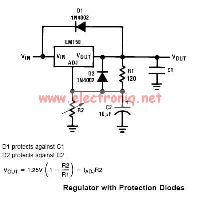

A possible (guess) answer - the older style LM317 or LM117 series regulators had a very low reverse voltage withstand (-0.6 volts, compared to the -15 volts min for the OP's LM2937).  If it was ever possible to crowbar (short) the input voltage terminal to ground, the output cap. (now at positive some volts above the input pin) would fry the regulator.  I vaguely recall an app note, or an old RAP article, somewhere, that described this failure mode, and advised a diode on the output leg to prevent the problem.

btrueblood: "very low reverse voltage withstand"
That's the one I was thinking about (my less likely explanation #2). But now I seem to recall the solution was a 'backwards' diode in parallel output to input. The diode would allow the output capacitor to discharge around the regulator.
So I'll put a dollar on 'shaving-off' some output voltage.

Uh oh.  Now we've got a fight on our hands VE1BLL!  First one to find the app note wins, loser buys a round.
Seriously, you may be right, and a quick glance through the datasheets for the LM317 series failed to locate the circuit diagram...ah well.  The problem with your solution would be the possible zapping of the diode if the reverse current could get high enough, the problem with a forward diode is the voltage drop, thus using a Schottky with its lower Vf...

Not an app note, but I found this (image below) with a quick Google Image search using the obvious keywords.
RE: LDO regulator with series Schottky diode
I owe you one!
