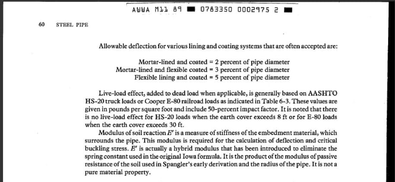

Basically my problem is this:
In a project we are finishing right now,the penstock diameter is 4500m. We measured the roundness of the pipes, 4 measures in total to know the OUT OF ROUNDNESS, and it must comply with this:
Dmax - Dmin <= 45mm (1%) -  based on ASME VIII UG-80
The problem is that some penstocks have an out-of-roundness over 1%, like 2% and 3% the most critical. I think that ASME VIII UG-80 is very rigorous, with the tolerance of 1%, for the specific case of high diameter penstock as it is for pressure vessels with much critical conditions like higher pressures and temperatures, so I was looking for a standard that may give me a little more tolerance, let's say till 3%. A lot of literature refers ASCE MOP#79 but I's been impossible for me to find it. Any ideas???

AWWA M11 allows out-of-roundness for steel pipes up to 5% and for steel pipes with cement mortar lining up to 3%.
Please make sure where you are making your measurements. if it's buried then the bed preparation and compaction is of great importance to control the ovality and the measurement should be made after the backfill.
for the ASCE manual, contact them through their site.
May I ask why 4 measurements and how you decide where to make the measurements along the penstock lenghts? this might give a better insight to your problem.

hold on, AWWA is for water transmission and distribution lines, not for hydropower installations. You designed the penstock with a high tolerance. Why are you so anxious to accept such a critical part of the plant when it does not meet the required specs? And if you are so anxious to accept this out of tolerance pipe, why do you need to find a code that will support the new tolerance? If you did not design the penstock then get the designer to approve the change. If you did design it than just evaluate the submitted materials for constructability, leakage, pressure test etc. and either approve it or not.

As said before, one should specify where the deflection of pipe is being measured. In my previous responds, I've assumed that the measurements and deflection control are after the installation.
Regarding what AWWA M11 really says, please take a look to the manual under "6.2.deflection determination":
