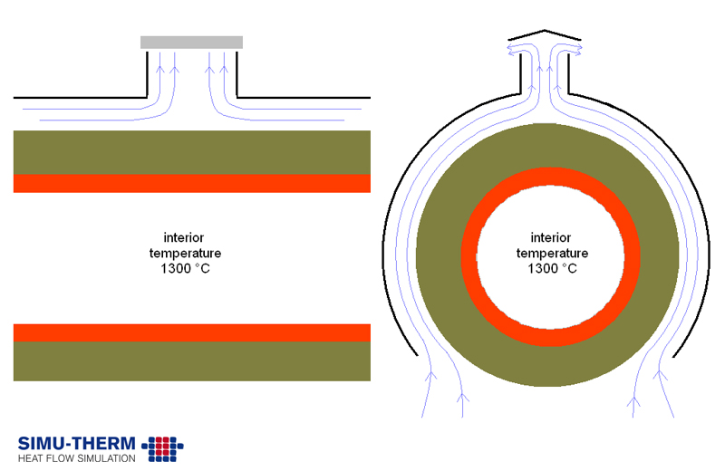

I have a problem with the thermal design of a waste heat boiler. The equipment will be installed outdoor and the difference between the winter (-25ºC or -13ºF) and summer (40ºC or 104ºF) temperature is a great problem. My colleagues and me, we are together thinking about something that will protect our waste heat boiler from the wind and rain in order to keep a right temperature profile in the equipment. Then we have thought about designing a rainshield or windshield for the equipment but we don't know how to size it.
Could anybody help us on designing it?

I mistook the equipment. It's a steam superheater, it's true it must be installed outdoor and probably alone, only connected by piping (inlets, outlets). If you can, please, visit this addresse and you will understand what I mean.
http://www.simu-therm.net/air-or-gas-spaces-in-refractory-walls.html
As you can see it's only a metal thin sheet or plate. But the problem is the airgap I have to leave between it and the shell.
Thank you.
