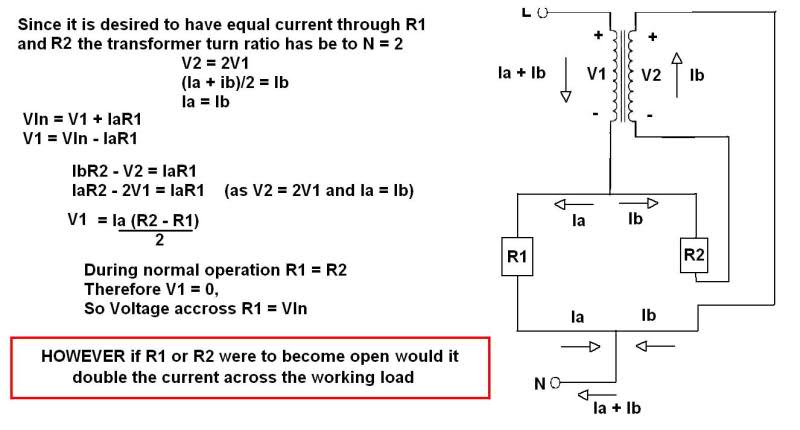

One of our heaters has a transformer that had load connected between primary and secondary windings. Can anyone give any thoughts on what does this type of connection mean... any ideas would help...

Looks like an unsuccessful attempt at using a transformer as a buck or boost autotransformer, but it's hard to tell.
Is that exactly how it is wired?
What is the line-neutral voltage of the source?
What are the voltage ratings of the two transformer windings?
What is the rating of each of the two loads?

Each of the load is four heating elements in series.
The Line voltage is 500V 1000A.
I have no details of the transformer winding.
Yes this is how the load is wired.
Just trying to make some sense out of the configuration.

Might that be a 1:1 transformer with a winding in parallel with each load group?  (Same connections to load; different transformer internal connections)
With the high-voltage high-current loadss you are showing, it may be that a 1:1 transformer was used to stabilize the voltage drops across the groups of loads.

Rearrange the circuit as shown on the attached drawing.  The transformer would be subtractive polarity 2:1 ratio.  The transformer forces the currents through the heating elements to be equal.
If the heating elements were the same resistance, there would be no voltage across the transformer windings.  If one resistance was lower, there would be a voltage across each transformer winding that would reduce the current through the lower resistance element and increase it through the higher resistance element.

jghrist ....I sincerely appreciate your efforts ....
BUT IF ONE OF THE LAODS R1 or R2 were to become open would it double the current trough the working load..
RE: Weird Transformer Load Configuration
Actually, if R2 becomes open, no current flows across V2 and therefore no current can flow across V1. Current can not flow in one winding if it can't flow in the other, the amp•turns values have to match.

I hate to respond to my own post, but...
If R1 is open there will also be no current through R2. Look at your equation (Ia+Ib)/2=Ib. It is true under all conditions. If Ia is zero, the only solution is Ib=0. If Ib is zero, the only solution is Ia=0. Trust the math.

It may help to remember that these transformers are acting as current transformers. If the resistive load on a current transformer is reduced, the transformer increases the voltage in an attempt to maintain the current.
If the transformer is chosen so that the voltage across the windings is approximately  1/2 line voltage, then in the event that one load goes open the transformer becomes a very low impedance in series with the remaining load and the voltage across the remaining load will be close to line voltage.

Sorry Bill, but I have to disagree. Amp•Turns have to match on both sides. In a series connected transformer worrying about voltage across the transformer leads to many false paths. For example in a CT, the most common example of a series transformer, the secondary current is proportional to the primary current by the ratio. If the CT is shorted, full current flows and no voltage is developed. If the CT is open circuited, the current still flows, but enough voltage is developed the force all of the secondary current through the magnetizing branch. This can result in thousands of volts across the secondary while still having essentially zero volts across the primary.
In this case if R2 is open, the zero current in Ib will cause full line-neutral voltage to appear across V1 because Ia will also be zero. If R1 is open then Amp•Turn balance requires Ib/2=Ib, for which the only solution is Ib=0.
All of this assumes an ideal transformer. In reality there will be some magnetizing branch current and Ia will only be very close to zero for R2 open and Ib will only be very close to zero for R1 open.

The part I am having trouble with is the case when R1 goes open. This leaves us with a series circuit, One winding, R2 and the second winding in series. Since the same current must flow in all parts of a series circuit, and since the turns ratio has been suggested as 1:2, the amp turns must differ between the windings.
What am I missing?

Amp•Turns can't differ, therefore the only current that meets the requirement is zero. Ignoring losses and magnetizing current there will be no current if either load is open.
Consider a normal step up or step down transformer connected line-neutral on one side. If there is a short circuit on the secondary there will be a large amount of current on the primary, limited only by the impedance of the transformer. But when the secondary is open circuited no current (ignoring losses and magnetizing current) flows on either side. Why isn't there current on the primary? Because there isn't current on the secondary and the Amp•Turns have to balance. Same in this case. However much it might look like a circuit exists, if current can't flow in one winding it can't flow in the other.

Nice explanation, David.
I suppose the question is now, what does the circuit do?
It appears that if either load goes open circuit there will be no current flow in the other load.
This seems to be at variance with what was requested by vds002's company.

When I posted my previous sketch,I marked the instantaneous polarity wrong, making it a bit hard to tell what I was talking about.
Looking at a corrected sketch, it can be seen that the 1:1 two winding transformer can be connected as a 2:1 autotransformer.
The autotransformer will split the supply voltage, and will thus stabilize the neutral point between the series loads.  Should one of the heater strings open up, current will bypass the open string, but maintain the proper voltage on the remaining string.
With an autotransformer arrangement, we can't easily predict what the currents are through the individual windings.  Some portion of the current will pass through the winding bypassing the open load and contribute directly to the remaining load.  Another portion will be transformed at a 1:2 current ratio to make up the remainder of the normal current through the remaining load.
As well as maintaining design voltage to the remaining heater string after an open, this arrangement gives another benefit.  Because the OP pointed out the each branch of the heater load is four series heater units, the autotransformer gives some protection against heaters failing shorted.  If all 8 units were in an unstabilized string, one unit failing shorted would raise applied per unit voltage by 8/7ths, likely failing another, possibly to a cascading failure scenario. (8/6ths, 8/5ths, 8/4ths, etc.)
The auto will limit the per-heater voltage in the failed shorted half-string to 4/3rds nominal heater voltage, but a cascading failure will still be limited to only half of the total heaters.

Each string of heaters will have 1/2 of the L-N voltage across it.  I don't see the advantage of this over just having two strings in parallel, with string each rated for full L-N voltage.  No matter what happens to one string (except having a complete short), it won't affect the voltage across the other string.  The autotransformer arrangement does nothing to stabilize the current.  It will be (VL-N/2)÷R.

Agreed...  The putative series configuration may have been chosen to make standard available heaters work with availalble voltage.  With a 500 V supply and 1000 A load, it seems odd from the get-go as far as design is concerned.
I'm just trying to puzzle out a reasonable interpretation of the original sketch.  By moving the N connection from the right side winding to the left side it could also be simply a voltage matching transformer between supply and heater requirements.

So now it is 1:1?  Assuming additive polarity, the current on each winding will flow toward the node between the loads.  With both loads in place there is no current in the transformer.  If either load is open, you have a situation where there would be a loop current through the remaining load driven by the current passing through the transformer winding in parallel with the open load.  I'm not going to try to figure out where it stabilizes, but I doubt it results in constant output of the remaining load.  Again, just put the two in parallel.
