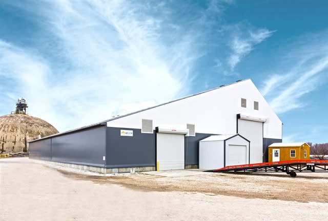

I have an installation of a horizontal lifeline in a salt plant where we used all stainless steel anchorages and cable.  We inspect it yearly and after the first year in place there were very slight signs of corrosion (apparent rust staining) in the grooves of the cable.  In the second year inspection the rust staining is worse.  The cable does not appear to be becoming compromised but we were shocked to see it appearing to rust.  Has anyone else run into a similar situation where stainless steel cable rusts?
