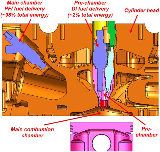

Here's an approach from Mahle that achieves essentially the same results as TSC, but with less costly and more durable hardware.  This Mahle pilot ignition system gets very close to CV combustion conditions, with very little NOx and good SFC.
http://papers.sae.org/2010-01-2260
Terry
