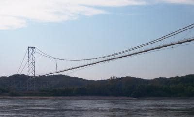

But if you remain determined to build a bridge,
http://www.spstexas.com/main/products/suspension-and-cable-pipeline-supports/
2161 ft span
http://www.bridgemeister.com/contributions.php?type=P&pg=1
As you can see, most of these are natural gas pipeline bridges carrying pipe with diameters in the 24-36 inch range at flowrates of products that could be worth billions $$$ per year, so the high cost of such bridges is relatively small in comparison.  4" of steam brings a completely different world of economic constraints to the table.
