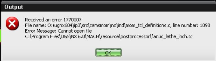

So i installed the 3 files, and go to post my tool path. Doesn't surprise me that I get some dumb parse error! Now what?
This is just crazy.... Someone please help?

If you are using a local install, meaning you installed directly to your pc, they can go into the post processor folder. I haven't used that method and believe you will have to browse for the post though, at least the first time of your session. Might be wrong on that though. All 3 files make it available in Post Builder but the pui is what creates the interface in PB. The other 2 files are the heart of the post and what actually drive the code. Early NX used only these 2 files until PB was created and brought it into an interface to use instead of writing code directly in the files. Hope that wasn't confusing. That radial is a switch in the machine setup which makes it diametric output. Easy.

Was there a cdl file with it? As usually a parse error is cdl related.
RE: NX6 post processing
no cdl file, i am dropping the 3 files directly to the post folder on c drive, and get the error. im using nx6 if that makes a diff.
Make sure the .cdl, .tcl and .pui files do not have hidden extention of .txt on them.  I have seen this happen when downloading files.
What is the error you are getting?
There has to be a file of that name in that path for this to work. fanuc_lathe_inch.tcl and fanuc_lathe_inch.def. Check your path and your file names and extensions.
Here are the 3 files i installed in the post folder. This is exactly how they read with extensions.
fanuc_lathe_inch.pui
I'm pretty sure I'm doing everything right?
Are they in the folder designated in the error?
C:\Program Files\UGS\NX 6.0\MACH\resource\postprocessor
yes, that is the folder that I installed them in. This is just crazy. This should be a no brainer. Very discouraging... I do appreciate the help yho
Go to help logfile and save that somewhere and post it. I don't think it will help but it might.
ok, i finally got it to work. It still posts m 'X' numbers in radial. Can someone guide me where to change this to diameter in the post?
