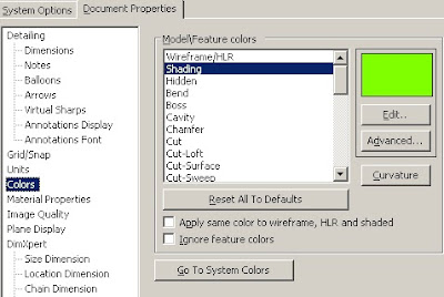

On the Colors Tab of the Document Properties settings in Options there is a radio button to check to
[]Apply same color for Wireframe, HLR and Shaded modes.

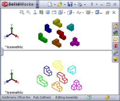

 This property cannot be set for Assembly files but if all the Parts in an assembly have this Document Property option selected your Assembly will show parts in the same color in any line display mode. See example below
