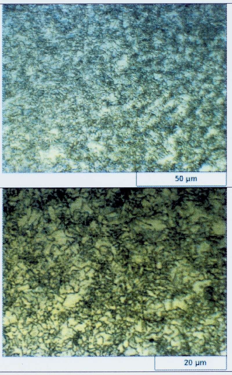

I am looking for some help on this picture (attached)
Ii is a resistance spot welded metal. Actually this picture is taken from the HAZ near to Weld metal.
The base metal structure is ferrite and pearlite and the chemical composition is :
C 0.15
Mn 1.02
Si 0.2
P, S, Al, Co, ~ 0.006
Mo 0.002
Cr  0.01
Cu 0.04
and the weld metal structure is martensite.
In this picture the steel is etched by 2% nital solution.
The laboratory told me the structure is ferrite grains with regions of pearlite, small particles of cementite and a little tempered martensite.
I know that the bright matrix is ferrite phase, can anyone tell me what part is pearlite or tempered martensite?
Do the laboratory told me the truth?

Sorry, but I can't tell from your attached micrograph. Do you have a higher magnification view? Did you have any microhardness testing performed?

and this is the best pic that I have got.
I know the resolution is low :( but this is all I have got.

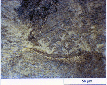

and this is the weld metal structure:
RE: metalography question
Honestly the micrographs are so poor I don't know how they can make a call.  The last pic (weld metal) is better, and I can identify lath (Widmanstatten) ferrite from the prior austenite grain boundaries and probably bainite elsewhere.  The hardness (for the chemistry given) certainly suggests bainite.  But any self-respecting met lab should not need to refer to the hardness to identify carbon steel phases.

So you say that the WM (weld metal) structure is bainite and lath ferrite?
If so, Let me notice the process, the metal is heated to well above AC3 (austenite) temprature and is cooled at about 5000 'C per second.
As I know forming of bainitic structure needs less cooling rates and also time to be made. plus identifying bainite from martensite by nital etchante is not easy.
So, Is there any possibility that the weld structure be bainite and lath ferrite?
I think it is martensite and lathe ferrite.
and about the HAZ (first poor pic) What is your opinion about it in brief? any suggestion would be great.

If this is indeed a resistance weld as you mentioned, you have highly localized heating and probably the highest cooling rate for any weld process.
With that said, and given the chemical composition of this steel, the weld region will simply be a re-cast structure of the original base metal composition. This means, the weld region should be ferrite/martensite with the expected cooling rate (look at a CCT diagram for this steel). The heat affected zone adjacent to the weld region will be a combination of ferrite and pearlite and possibly bainite/carbides. I don't see how you will have tempered martensite.
