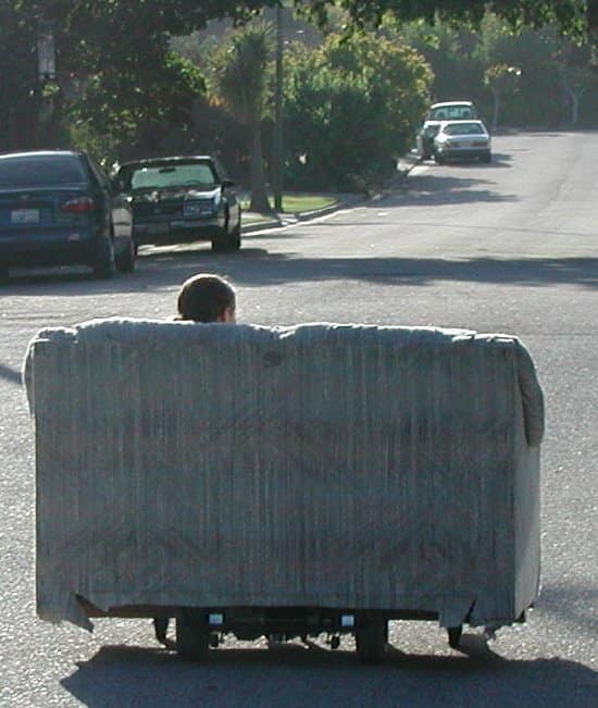

You can find some pretty tough mobility scooter drives for cheap on ebay.  I did.  Remember the motorized couch?
They also get you an automatic band brake.

I don't recall a motorized couch. I expect it did not sell because most couchs are so large in respect to the room size.
I guess it would help moving it in when new, and out when it becomes old.
Now I do know of the vibrating couch, but that would not be much good for this application.
There are premade wheel motor applications for use in robot construction.
RE: AC vs DC Motors
Looks like I could drive it to work, but it wouldn't fit on the elevator.
