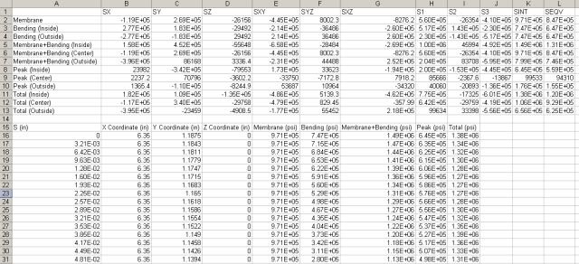

After trawling through previous posts regarding stress categorisation I have landed here with a new question. Hope you can help.
With regards to ANSYS and ASME VIII Div 2, there seems to be questions regarding ANSYS' method of stress categorisation.
I am currently working with V12.1 which generates a handy Excel file for your selected path line, or "SCL" in this case. In the Excel file it appears that ANSYS has already categorised the stresses into Membrane, Bending, and Peak etc.
Also provided is the Stress Intensity, or Equivalent Stress, if required. Please see image below.
http://i234.photobucket.com/albums/ee269/craigclavin/ANSYSOutput.jpg
Surely it cannot be as simple as comparing these values to the recommendations made in ASME? Please see image below.
http://i234.photobucket.com/albums/ee269/craigclavin/allowable.jpg
I feel like I am missing something pretty huge, or that ANSYS does NOT assign the stress categories inline with ASME, meaning all the hard work is still to do......
Your thoughts and comments are appreciated.

What ANSYS cannot do for you is to separate primary and secondary stresses (usually the most relevant part of stress categorization).
The constitutive character of secondary stresses is that they are self limiting, and only a plastic analysis can test this condition.
So you need to decide whether your M or M+B stresses are primary or secondary to complete the stress categorization.

Thanks for the reply Prex,
To put it in black and white for me
Once I am satisfied I have defined M and M + B as either primary or secondary, then I can compare the values to those recommended by ASME?

GlorifiedTap, I will answer that question directly.  I believe that ANSYS linearizes the COMPONENT stresses correctly.  However, my issue has been how the COMPONENT stresses are combined to form the SINT and SEQV linearized M+B stresses.  You will note that 5.A.4.1.2 directs you to only use the hoop and longitudinal M+B stresses and the M stresses for the remainder of the directions/shears in calculating the invariants.
If you can confirm for yourself that ANSYS is doing it correctly, then you are fine.  Last time that I used ANSYS, I could not confirm that.  And, as an example, in ABAQUS, you have the option of choosing which components to use in the calculation of the M+B invariants.

With my current basic knowledge I have concluded that SINT is derived as per ASME, I believe it's something along the lines of "maximum value of the stress differences". This seems to check out ok.
As for the equivalent stress, I have applied the von Mises equivalent stress equation given in ASME to S1, S2, S3 provided by ANSYS and I get the same that ANSYS gets.
Perhaps ANSYS can confirm that the bending stresses are indeed calculated using the local hoop and merdional component stresses.

Are you saying the laborious process of stress linearization is not required if we perform an elastic plastic analysis?
That is something else i have had a play with using the calculation for tangent modulus from ASME.
Craig
RE: Stress Linearization in ANSYS 12.1
Yes - that's exactly the point.  If you perform an elastic-plastic (EP) analysis, the process of stress categorization and stress linearization go away.
In my opinion, EP is the way to go.
