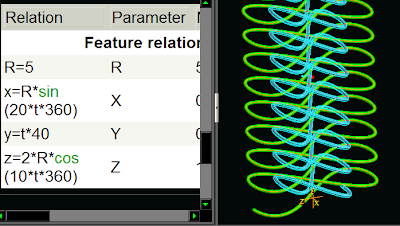

Hi guys,
Is it possible to do a helical type sweep, but in a figure-8 format?
e.g. imagine a spring wound in a figure-8 style, around two parallel mandrels?
cheers,
Dave
RE: Figure-8 Helix
Figure 8 is not the same as square helix.
Curve by Equation can do this. It just depends on how exact you want your circles or if you want exact radii or not.
/* Equation Data
R=5
x=R*sin(20*t*360)
y=t*40
z=2*R*cos(10*t*360)

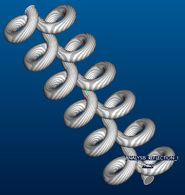

This is actually a loop of thick cable stowed on arms protruding from some sub-sea equipment.
I modified the equations a bit to include editable parameters (number of coils, aspect ratio, cable diameter) and to make the cable touch at the cross-over point: -

In actual fact, I can do this without patterning at all, by having a continuous curve of 'n' coils, represented by: -
n=coils
r=radius
d=diameter
x=2*r*cos(n*360*t)*sqrt(cos(n*360*t)^2)
y=2*r*cos(n*360*t)*sin(n*360*t)
z=t*d*2*n
I can even have the half coil, e.g parameter: coils = 4.5, to make the cable terminate at the opposite end to the start.
Sweet!
