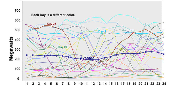

RE: WTG Production losses & uncertainties
                    variablity of wind
