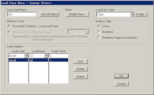

When I define a load case in SAP2000, there are two types of load. One is "load pattern", and the other one is "acceleration".
If I define acceleration in "UZ" direction, with scale factor of 1, what does it mean? The scale factor is the factor of what? Factor of the gravity?
I defined an acceleration load to a cantilever with uniform mass, but I get some concentrate load reactions. I do not understand why.

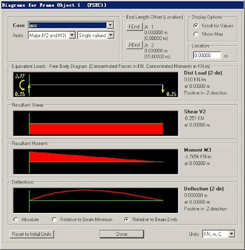

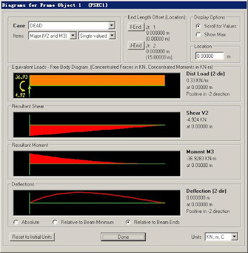

Following figures show my cantilever. There are only two Load Cases, DEAD and ACCELERATION.
I did not assign any load to neither load case. The cantilever has selfweight only, and it
is 15m long.
Could some one tell me how the software got the reaction of 0.25kN in Figure 3?

I will check your models later
but for now, please remove the mass of the beam and put a point mass at the tip.
Then run the model, check the results
It is the mass of the beam that is confusing you. Use one simple mass at the tip

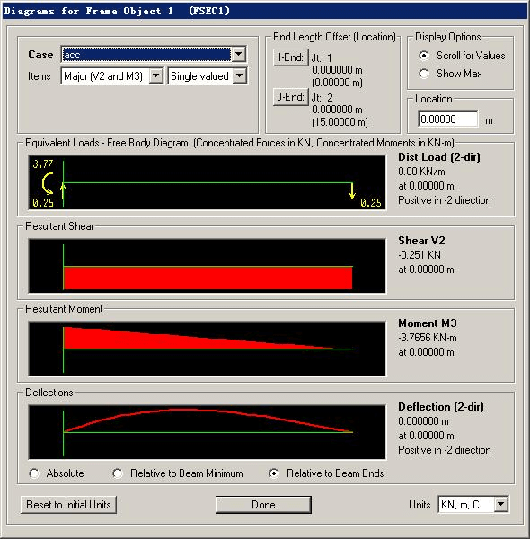

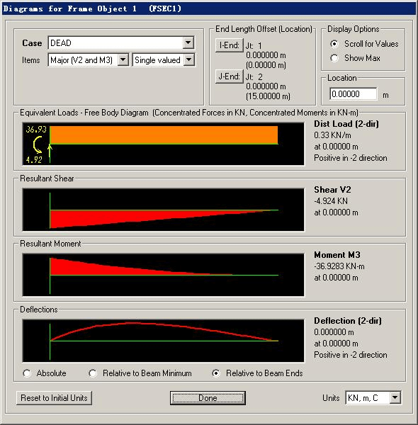

Sorry, the pictures are down. I post them again.
Figure 1. Acceleration Load Case.
Figure 2. Result from Dead Load
Figure 3. Result from Acceleration
