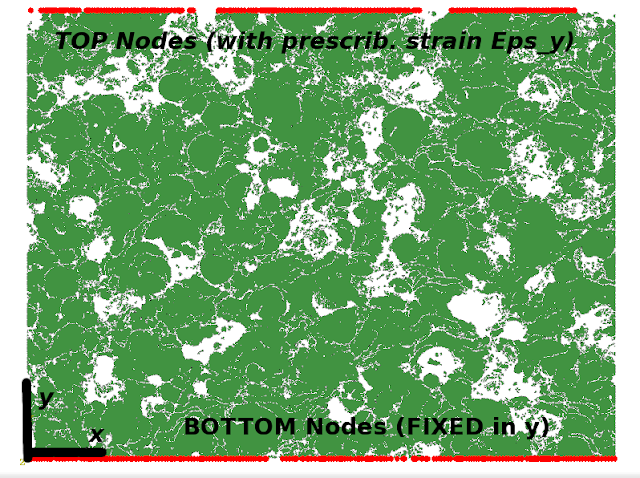

Suppose we have a microstructured 2-phases material with random inclusions (or a porous material with random pores) and we make a real tensile test (monoaxial loading in the vertical direction of a specimen with nominal length L). We want to model such tensile test with FEM (for instance with Abaqus) like in this pic:

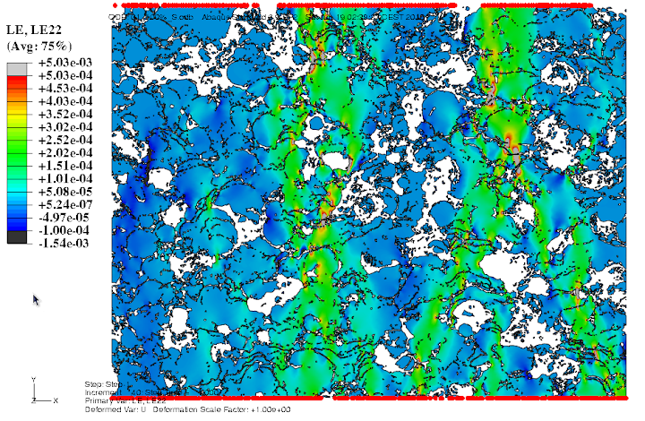

We can model the microstructure of the material, meshing a 2D subregion of the real specimen (like in the attached pic), so that the FEM solver can output a "strain field" across the 2D region at each time step of the simulation. Here an example [LE is the total log.strain~eng.strain for small elong. values]:

The simulation makes the Bottom nodes of the model fixed in y and assigns to the TOP nodes a prescribed maximal strain (for instance 1%). Left and Right nodes can move (poisson effect) but parallel on the vertical axis.

Q: homogenizing stress by area is ok for me BUT for strain I have some doubts..: if a average strain over the area, than of course I underestimate the strain taken only from the TOP nodes (option A). This becasue I include in the average also those nodes closer to the fixed bottom part which have a lower strain.
What is the right way to calculate the average strain in order to compare it with experimental curves?

I calculated both strain on TOP line and strain over area. The mismatch is surprisingly high.
<Strain>TOP_nodes ~ 5*<Strain>area !!! (the second one using LE output from Abaqus).
