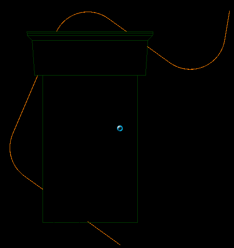

I have a solid model, and I am creating some sketch lines that are on the surface of this model.  The problem is, as I rotate the model, the lines that are behind it still show through.
How do I get them to stop showing through.
I checked the transparency of the solid feature and it is not transparent.  I looked through the settings, and could not find anything to fix this.  If anyone could help me out with this, I would greatly appreciate it.
I have attached a screen-shot to better illustrate what I mean.
Thanks much,
--Art.

I want the sketch to show up, so I don't want to hide it.  I just want the parts of a sketch that are behind a solid object to not show.
gurjjeet, thanks for the help.  Your suggestion of making it an extrude cut doesn't work, since it wants to cut the entire model all the way through because Im using just a line as the "cut shape".  However, if I do it as an extrusion, then it does work.
However, it just seems like there should be a setting or something in solidworks that I can check a check box and make it so that sketches don't show through solid features.
I guess this is a good enough workaround, thank you for the very quick response, I appreciate it.

The sketch is not part of a feature, it is just referenced to it.  I don't want to hide it.  I want the feature to show up in the 3D view.  The thing is, it is showing up "through" the 3D feature.  It's as if the 3D feature is transparent (transparency is turned off).
Basically, imagine extruding a cube.  Now make a 3D sketch, and draw a line around the entire cube, this gives you a square that is on the surface of the cube, kind of like an equator.  Now, what I want is for the part of the sketch that is in front of the cube to show up, but the part of the sketch that is on the other side of the cube to not show up since the cube is in front of it.  But the problem is, the whole sketch is visible, even the parts that are behind the cube.
