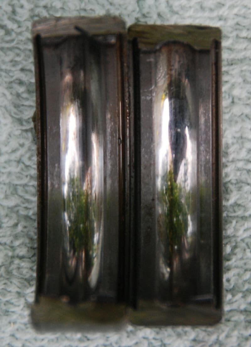

I have a 56J 1/2hp 3Ph Baldor (CJM-3108) that seems to make a lot of noise spinning.  I have it hooked to a VFD and when I turn off the VFD it terminates all drive, like a knife, and the motor coasts down to an eventual stop.  During this coast the motor doesn't seem to make any failing bearing noises they just seem... like they are too mechanically connected to the motor end plates, and case, and that they're all sound-boarding the noise.
Or, am I wrong and there should be no noise other than fan fan noise?
Are there any techniques for remediating this?  Can your get bearings that are resiliently mounted?  Any other thoughts?

I'm assuming it makes noise during running and coasting, right?
Does it make noise consistently during coasting, or only certain speeds?
Regarding rolling a bearing in your hand:
1 - I agree with you that a little bit of drag is normal. The grease friction is high when the bearing is stationary and cool... goes way down during running condiitons.
2 - I have seen bearings with lots of damage that "felt good" when rolling by hand but a different story when cut open.
Tough to draw any conclusions but my guess on the two biggest suspects would be: bearing defect and skidding.   If bearing defect you can pick it up easily on vibration spectrum or by disassembling the bearing.,  If skidding, perhaps you will notice the bearing running hot.

I would say bearing. Since it is sealed, you can't see the rolling elements. The wavy washer is to accomodate the axial thermal expansion.

Do you mean that the noise continues after the motor is de-energized? Any time I have heard bearing noise n a small coasting motor, it has been bearings failing.
How long in service? I had a bearing fail catastrophically the first day of service. The retainer that keeps the balls spaced was faulty and the balls bunched up and jammed the shaft.

Another thought. After ten years of inverter duty the bearings may be damaged by bearing currents.

Thanks for all the suggestions!
Quote (electricpete):
Yes pretty much exactly the same noise. There is ZERO pwm noise at the 12kHz modulation I am using.

BTW: I've pulled the bearings and pried one open.  Still packed with functional looking grease but I couldn't see any obvious issues.  I'm not willing to tear them all apart, clean them, and look at them with a microscope at this point.
If I was, I'm not actually sure how you get them apart? Do you have to mangle the carrier?
I'm proceeding with bearing replacement and will report on the results.

Keith - some ideas on taking the bearing apart for inspection:
The toughest part is separating the outer ring from the rest of the bearing.   Two ways (1A and 1B)
1A – take it to a machine shop and have them cut it with a Metabo cutting wheel.
1B – If you don't have access to a cutting wheel,  drill out all the rivets in the cage, remove the two havles of the cage (one on each side, previously held together by rivets but now separable), move all the balls toward one half of the beairng, and pry between inner an douter race until beearing pops apart (have your safety glasses on).    It sounds like you may have pried it apart with cage intact?    That's hard to imagine.
2 – Once you have the outer ring removed, if not already done you need to remove the cage.  Cut it with plyers at 2 points 180 degrees apart.  Cage comes off in 2 pieces (with balls included) and you can inspect inner ring.  You also have good inspection of balls without removing them from the cage, just spin them in the cage.
3 – Put solvent like paint thinner in a container enough to submerse your parts and rub the grease off.
It might seem like a hassle but if you've gone through this much trouble you might as well go the final mile to see exactly what the bearing surfaces look like imo because your corrective actions would be a lot different if you find bearing in good condition (not likely but possible) than bad.

Thanks for the continued detailed discussion.
Looks like I should've hooked up an ammeter between the case and the shaft and run the motor with the VFD before I tore it down. If I saw current it would immediately justify something like Aegis.
And Jeff, the previous service was intermittent, and once it's put into service again it will be 24/7/365 running on a VFD, so, insulation or a current shunt makes a lot more sense.
But since I didn't measure the current I will inspect the bearings.
I love it.  The VFD is about $120 and a single Aegis for the motor is $108.94 + tax.

I cut the bearings open.  It was actually really easy.
They are quite shiny with no apparent scratches. They weren't as clean as I thought, but, I think you can see the mirror finish.  They are laying on a towel so you can see the scale of the magnification. Sorry for the file size - these were cut to less than 1/8th of the original dimensions.
Bearings in Repose:
Top lighted at about 200X magnification and very clean:
Keith Cress
RE: Motor noise reduction.
T'was the bearings.
I put in new bearings and ran it again.
World of difference.
The only noise was the fan. No rotational noise what-so-ever.
Some of the improvement was likely the double seals verse only the original shielded bearings.
Kudos.
Keith Cress
Kudos returned to you from someone just lurking.
It is good that some have the stamina to go through all steps sometimes.
