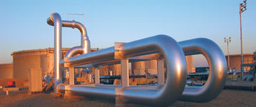

Crude oil and refined products are always custody transferred at a standard defined by the custody transfer contract.  Great pains are taken to ensure accuracy by calibrating the flowmeters by running a prover loops at the beginning of every shift, significant change in pressure or temperature, significant change in ambient temperature and on every change of product.
In fact the same standard volumetric error in a gasoline measurement would be 126 times more significant than the same error in a natural gas measurement, if you consider paying for BTU content in a standard volumetric unit of each.  Nobody likes getting paid less than they deserve, or more than they should for these high volumes, so great care is taken in standardizing each gallon to the exact standard condition as specified in the sales contract.  Liquid prover loops used at a tanker loading terminal can cost millions of dollars.  When you realize that only a 1/2 % error in loading a supertanker can mean a fight over 1 million dollars, you get some idea why a proof of exact liquid quantities becomes important. At some crude import/export terminals that error could easily mean
2 Billion dollars a year (even at today's low price)
Prover Loops,
http://info.smithmeter.com/literature/docs/liquid%20flow%20provers.pdf
