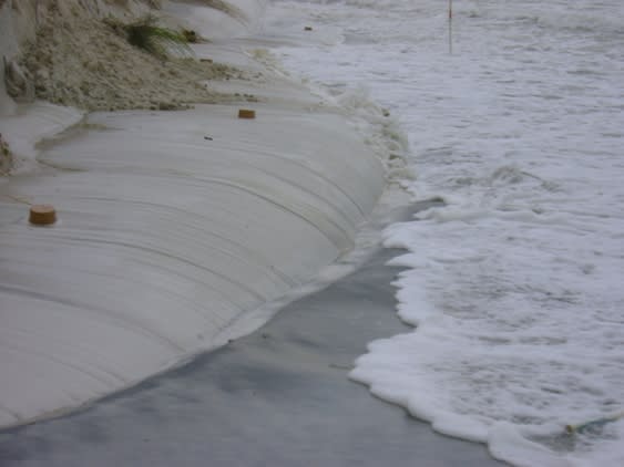

And you thought that  a  vortex was only required for commodes to function properly.  This is one of several types of apparatus being evaluated by people of all dimensions.
Voraxial Oil Separator
Http://www.evtn.com/home1.html
I went over to the beach to see this material demonstrated.  it works as described and is relatively inexpensive.  It is a Urethane fabric and has the ability to host some super microbes that start immediately start to work on the oil.
X-Tech Fabric
http://www.spillcontainment.com/products/stormwater/x-tex/AM3.
Saw an interesting conversation that illuminated the problem of getting anything accomplished.  There are 35 government  agencies involved that have to give their approval before anything is presented to BP for a yea or nay.
They had one show and tell where a gentleman was using very dry straw, like was used in the Santa Barbara Spill,  He asked the CG about using it and the reply send back was that it will soak up oil but you end up with a mess of oily straw, but no oil on the water.  The person who was demonstrating it asked about piling it up and burning it.  The answer to the question  Oh No that will cause  pollution.
