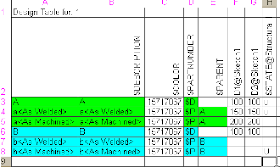

I have a weldment part with two configurations which have different sizes.
The configuration hierarchy is as such:
-Default
     -a
     -b
I would like to create a drawing with the two views of the weldment part and in the drawing attached. I would also like then to have two weldment cut lists on the drawing, one for each config.
In the weldment cut list in the drawing the only config I can select is default.
How do i do this? From what I can understand I need to make the config tree like:
-Default
     -a
           -a [as machined]
           -a [as welded]
     -b
           -b [as machined]
           -b [as welded]
RE: Weldment Configurations
Weldment Parts use what's known as Derived Configurations for the As Welded and As Machined versions for each parent config.
I'd suggest using a Design Table to achieve this.
You can rename the Default Config first so the names follow your desired scheme and can create the B versions by manually replacing the As with Bs or using search replace in the design table
If you go to Insert > Tables > Design Table and choose Auto-Create option you'll see a table with the Default Config and two derived configs listed below with a "$Parent" Column which tells which configuration the derived configs are controlled by.
