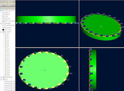

In Wildfire 2 the best option would be creating a Datum Point on curve to reference for your cut or other feature and then Pattern the point as you see fit to get your X,Y placement locations for your features. As long as your features reference the point and have orientation defined in the sketch you should be able to use a Reference Pattern. If you have multiple features you can group them together for a single reference pattern or pattern them each individually.
The Point on curve can be specified as ratio like .1 for tenth of curve length and this can be patterned easily. The problem is obtaining the XY locations you want. If a point is on the ellipse then it only needs an X or Y dimension because the other one is defined by the ellipse. To get the Tangent YZ plane you reffered to you can make a Datum Tangent to an Elliptical surface through a point on the curve. These features can be created and then hidden prior to patterning to reduce clutter. As long as your pattern contains references to the original point and a neutral plane you can keep parallel constraints other wise you can reference the Tangent plane or a perpendicular one and have the shape follow those so the orientation follows the ellipse.
Full Picture Link
In image shown above I patterned a point using ratio .05 starting with a .025 along curve ratio along elliptical curve. For an XY position pattern you'll need to dimension the X offset for each point and the Y value will be determined by ellipse. If you could attach a picture of your Brute Force model I'd be able to give better assistance.
Michael

I spoke with a colleague of mine and he gave the same advice. I have a set of datums patterned, I managed to pattern the feature in general but I need to polish the model to make it work all the way around the curve -- I have a non-continuous surface. After that the holes should remedy themselves as long as I reference the first hole to the initial feature which is linked to the initial datum group of the initial pattern.
My faith has been restored with Pro/E.
