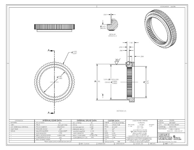

I have a drawing with 3 views (Side/top/right) and an Isometric view.
What standard would I go to, to give guidance where to layout these views on a drawing?
I.E. ANSI Standard XX.XX.XX

No this isn't homework, just a professional dispute.  From my education I have been taught to put the Isometric drawing in the top right corner and then the orthogonal views on the left side of the paper.
My colleague says that putting the isometric view on the left is just fine.  To me thats just looks bad and isn't very professional.
Check out the drawing I uploaded to demonstrate what I'm talking about.

I think the only reason for thinking an isometric view looks good on the right is due to general notes usually being on the left.

I think the ISO view on the upper-right makes some sense as third-angle project with top-front-right viws forms an 'L' shape. This leaves the upper-right open for the other view.
However, I don't think any standard exisist that says it must go in the upper-right. And with europeans using first-angle projection, it would be a reverse 'L', so the upper left would be the ISO view location.

I usually throw in a 1:1 scale iso view near the title block just to give a sense of the size of the part.  Most of our parts tend to be very small with even smaller features.  My default scale is 5:1 but lots of times they are drawn 10:1 with detail views at 50:1.  So the iso view is a little bitty thing that I just put in a convenient spot.  There is definitely no wrong or right place for it.
One thing that I am pedantic about is company title blocks.  We follow ISO standards so ANSI may be different, I'm not sure.  ISO 7200 requires the bottom right corner of the drawing WILL contain the drawing identification number.  Just above or just to the left will be the drawing title and the name of the legal owner.  Every company I have worked for, American and European, has followed this standard but I see many drawing formats, including the one posted above, that do not.  If you want something to get me going about professional looking drawings, start with the title block.

That could be very true, it was just standard for my professor to mark my drawings up if I put the iso in a different location.  I just assumed this was an industry standard as most the "real world" drawings I saw were of this same format'ish.

Actually, the included iso views are not a requirement per any industry standard.  While I have seen them included as a common practice, it depends on the company.
As MM posted, the most likely reason to place it on the right side is to allow for notes on the left side.  If the company DRM specifies that notes shall be on the right, chances are that the iso (if one is specified) will be on the left.
I'm with drawoh on this subject; the object is to clearly define a part.  Pre-specified required views are not necessary to accomplish this, and can add confusion to the drawing interpretation.
I also rarely use iso views, with the biggest exception being an exploded assembly.  Even those will have detractors claiming that they aren't really necessary, but they do often simplify the assembly definition.

Thee is no statement in the standards about even requiring the inclusion of isometric views, let alone where it is placed.  This is completely person preference.
