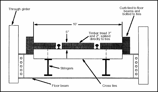

Paddingtongreen, the other girder framing into the splice could have the weld prep.  Also, the web connection is likely two plates, putting the bolts in double shear.  I doubt this is going into a column.
Here's a cross section through the type of bridge I'm envisioning this belonging to.  Of course, I could be wrong, but this seems the likely scenario to me.

I would not think that nutte is too far off.  Upon further review of the stiffeners/connection plates on web, there doesn't appear to be any top bolt holes for a full depth cross-frame or diaphragm from one girder to another.
So the idea posed by nutte has merit in that the two columns of bolts in the transverse connection plate likely support a cross girder.
It's just that most railroads and or light rails don't use continuity too much as the weight of the engines can put a span in uplift when continuity is used.  Of course, with the right span ratios....
