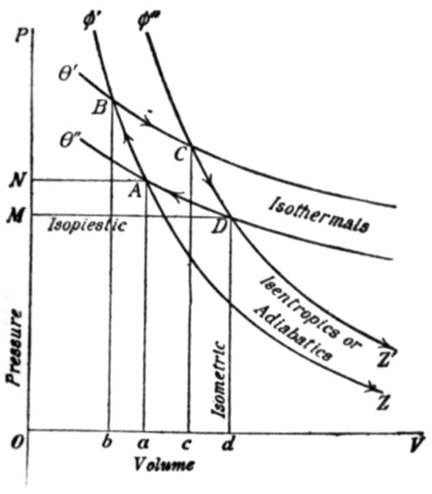

if a reciprocating compressor is 75% efficient, then the best you can capture is 25% of the energy going to the system.

NO, an air compressor can't throw away 75% of it's input energy, it uses 75% of its input energy.
RE: Air compressors room - Heat recovery
No,
If the air compressor uses 75% of the energy to produce compressed air the efficiency would be 75%.
