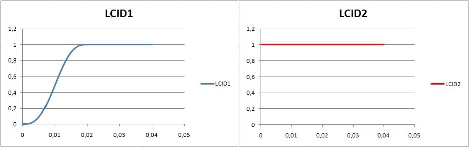

I am simulating a head/helmet impact. The helmet modeled with a foam material and is fitted on the head with initial penetration. I use the contact "*CONTACT_SURFACE_TO_SURFACE_INTERFERENCE_ID".
During the impact I can see that there is no sliding between the head and the helmet regardless of what coefficiant of friction I set on static or dynamic friction.
In the contact definitions there are two curves set.
LCID1: scales the interface stiffness during dynamic relaxation
LCID2: scales the interface stiffness during transient calculation.
 This is how the curves look like that I use:

The interference fit may have a default option to tie the adjusted nodes.  I'm an Abaqus user so I am not sure how LS-Dyna does it.  I hope this helps.
