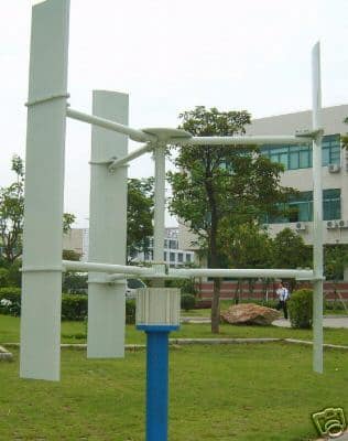

The good news is we will be building vertical turbines in Canada that will be superior to the horizontal.

RE: The good news about windfarms
So if I may ask, what is the difference between horizontal and vertical blades?
If the blades rotate, at some point they will be either vertical, or horizontal. Or are you talking about some sort of egg beater design?
He means rotation about a vertical axis.
They supposedly are somewhat better because they don't lose energy overcoming the gyroscopic effects of the rotating blades and equipment as they swing to the keep the direction of changing winds.
"The problem isn't finding the solution, its trying to get to the real question." BigInch
http://virtualpipeline.spaces.live.com/
So an egg beater design.
The "vertical axis" term would have explained it to me.
Yea that's right, vertical axis.
The R&D is not quire complete yet though.  smile
quite*  pipe
peace
Fe
Nope.  Technically the "eggbeater" refers to a Darrieus turbine,
