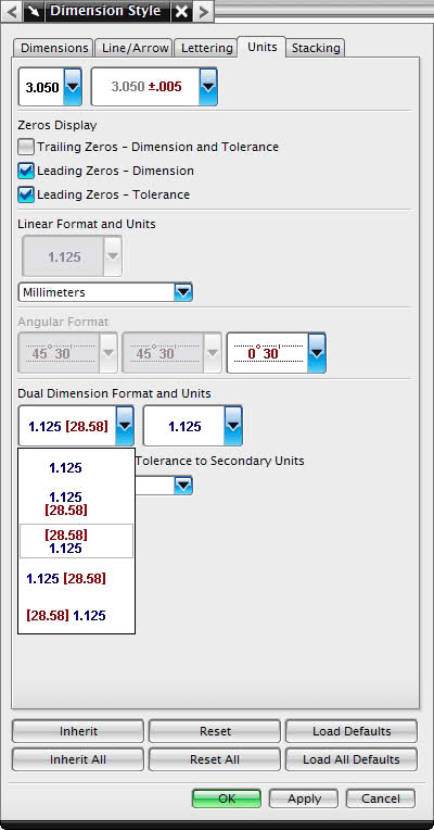

It IS already "embedded" in NX.  While in drafting, select a dimension, then go to Dimension Style>Units>Dual Dimension Format and Units.  See the pic:
RE: Square brackets for dual dimensions in note
potrer, the OP is trying to do that to a note, not a dimension.

ahh, whoops, sorry.
