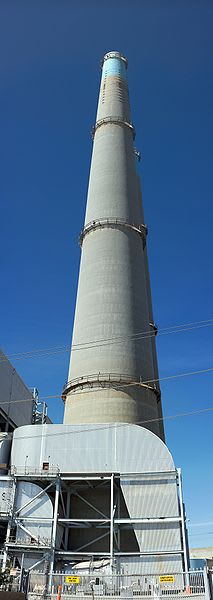

I built the electronics for a couple of totalizing massflow measurement units used in Moss Landing Power Plant.
It was multiple massflow sensors chained together across the base of the stacks which profiled the entire stack flow.  Then a sample port was also massflow'd which went to a particulate filter.  Every so often the particulate filter was pulled and weighed.  That was then compared to the actual stack flow.  This then equated to the particulate load leaving the stack.
