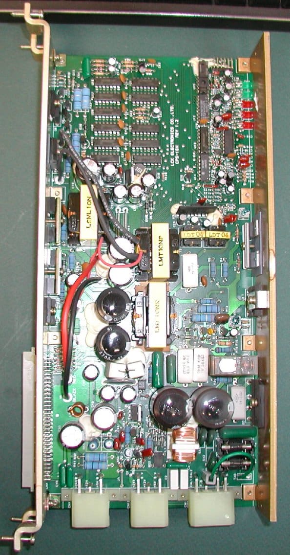

I have been handed a PS out of an old but valuable machine tool.  "Can you fix it?"
Argh!
It's about a 100~200 watt unit. It outputs 5V, +/-15V, and 24VDC.
I have NO schematics and only a vague field wiring diagram.
Extensive web searches for a schematic have only resulted in wasted time.
I did a very careful visual and see nothing other than the usual slight board discoloration under a couple of the square ceramic power resistors.
The fuses have never blown.
I hooked up the required 220V to it, and while cringing appropriately behind my eye protection, threw the switch.
A relay clicks and one of the LEDs lit declaring "source".  A voltage check shows 5V is present on a bevy of logic chips.
But!  I see no other voltages and if you listen very carefully you hear a faint chirp-chirp-chirp with about a 1.5 second period.
So my question is:  Any suggestions as to what should I focus on when the oscillation doesn't seem to get off the starting blocks?

The power resistors you see with a little brown around them are probably snubbers. They always heat.
Chirp-chirp-chirp. SMPS when unhappy will click, buzz lightly, or chirp. These sound come from the magnetics. Could be a overcurrent/softstart cycle re-occuring. This could also occur if the minimum load requirement is not being met.
Generally, as a SMPS ages, the electrolytics slowly dry-out and loose capacitance. They may look perfectly fine, or may be slightly bulged, have the bottom rubber seal slightly bulged out, or show a faint sign of leakage. This can happen to both power electrolyics, and small electrolitics used for signal conditioning
Optoisolators can degrade with a lot of age, CTR increases and the control loop may "open" resulting in the output going (usually) higher in voltage which may cause over-voltage protection circuits to activate, making the supply then shut-down in overcurrent. A properly designed SMPS may pull little input current when it's in overcurrent mode.
Also check the thermal pads under power devices. If it's the old zinc-oxide or silicon based thermal transfer, these can dry-out. Clean it completley and re-grease, or use a more modern type of thermal pad. But, your problem doesn't sound like this. A thermal problem usually shows up under load.
Also, some older SMPS use various inrush current protection schemes so the input electrolytics don't spike the line when power is applied. These inrush circuit sometimes eventually fail making it so there no or inadequate power  on the primary circuit side.

Scotty;  Agreed.  There is a pre-supply that is running the logic.  Hence that 5V.  I see a separate bridge rectifier which I think is running that.
Gunnar; I think these have died over about 2 years. Which seems to not point at line voltage.  I did try uping it and lowering it though.  No joy.
Bob; I am definitely fearing that.  I would not even try if it wasn't for the dweep, dweep, dweep, which means the supply is trying to run.
For your entertainment here's a picture of this pig.
You can see it isn't anything typical...  Its a CPS-10NB.
it has LG(as in cr*p cell phones) on it and LCK ELECTRONICS,  and its in a KIA Heavy Industries machine tool running the Yash-something drives.

You mentioned that the electrolytics were somewhat swollen. And they are, indeed.
Gunnar Englund
www.gke.org
100 % recycled posting: Electrons, ideas, finger-tips have been used over and over again...
RE: Troubleshooting a switcher.
But they're so uniformly swollen voluptuous...
Are you saying I should replace those??
I would just expect them all not to be swollen exactly the same if there was something nefarious afoot.
The bottom two are 200V and the next ones up are 63V so they aren't even the same model.

If you press on the 'bulged cap' tops there is no resistance. The little domes un-dome.
It is really rough trying to fix something this complex that you have NO schematic for.  Nor even a functioning example to at least make comparisons against.
As mentioned I don't even know if they come ON without some external signal.  I could replace everything on the board and discover that I wasn't supplying ENABLE.
If this was my supply and was preventing my money machine from spewing money I would sit down and draw a full blown schematic.  Trouble is, that would take probably (3) eight hour days.  Something I know they don't want to pay for.
If I had a full schematic I could actually do several things. I could layout a motherboard with the crazy logic on it,(one PLD), buy an OTS supply, and drop it on.
I could probably sell a hundred since I could come in way below the $1,400 going price.
I could also mark every device on the supply. Send it in to a repair place. Pay the $800 repair charge and see which parts get replaced.  Then do the the other 5 supplies the same way.  LOL

Hi Bob.  Naw, just picture lighting.  The entire unit looks out-of-the-box new. With the exception of the aforementioned slight darkening underneath the board under the power resistors.  There is not even a trace of dust on this 15 year old.
IR; ALLLLLLLLLLlllll the electrolytics have those blobs of what appears to be RTV somewhere on their bottoms. Often between them.  It is obviously factory applied in the usual business like manner.  Perhaps to mitigate vibration work hardening of the leads holding a big device.

Suggest you pull some of the electrolytics (both the big and small) and measure them. They're old enough to have dried-out, which happens with time, heat, and use. If they have, you will find the capacitance is 10% or less of what you expect.

Halfway along the copper-colored sink, near edge:
Is that:
- a water mark?
- a witness mark from a plating electrode?
- bleached from heat?
Mike Halloran
Pembroke Pines, FL, USA
Mike; Sharp there.
It looks to be an anodizing drip..  Nothing translates onto the board.
Rather than desoldering the existing caps I soldered on the back, more caps.  So if the capacitance was dropping to a point where the zeros and poles were too badly misplaced it would drag them back.  Made no difference.  I guess I'll wait for them to cough something else up.

Well I've been dragged back onto this baby.
I can now get it to attempt to turn on.
It's 24V supply ramps correctly as does it's 5V.
It's 12V only ramps to 8V and the supply's jungle logic trips the entire supply off in a fault condition that lights the 12V fault light.
This all transpires in about 20ms from live switch-on.
I now can hunt backwards thru the unit to see where the ~8V is coming from.

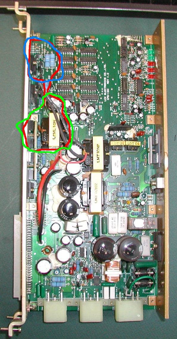

In the photo below the the red area is the lair of the 12V switcher.
The blue area is the area, including the transistor switch on the heatsink, that cuts the 12V off instantly when the fault is declared.
The Green Area is the actual 12V switcher. This includes the switches on the heatsink.  That transformer has around 10 pins on it.  (It's rumored to be + and -12V but there are no obvious -12V outputs anywhere.)
My immediate question is why does the 12V cap, (top of green area), have it's positive pin hooked DIRECTLY to one of the pins on the transformer?
If this makes sense to you maybe you can tell me what topology I'm looking at.  Then I can continue troubleshooting with one more arrow in my quiver.

Excellent point Mike.  This power supply actually has the old original RS-232 driver chip in it.
I don't believe there is any printer in the picture.  There is a paper tape reader.
Another interesting anomaly: I scope captured the signals seen on the switch hooked to the transformer.  There was total random AM hash on it, like the oscillation was uncontrolled and wild.
I doubled the filter cap capacitance - with no change.
Perhaps some small cap in the driving circuitry is bad?

See if that chip has a charge pump inside... I cannot recall if they made chips without them (requiring external voltage source), but if it has the pump, look elsewhere for an answer.
Dan - Owner
http://www.Hi-TecDesigns.com
No, its the old original "88" chip. Four drivers and nuthin else. So -12V is required somewhere. Plus since this supply runs a mother board with drive controllers and a dense CPU board something out there probably needs a small amount of -12V anyway. Makes sense.
Keith Cress
This is a cliff hanger! Sounds like your circuit for the presumed 12 V is somewhat unorthodox. An unorthodox circuit is what I would be looking for if several individuals fail after prolonged time. Of course, I would look for traces of high temperature also. But you did that already.
Gunnar Englund
www.gke.org
Yes sir.  And since there is the zener/logic circuit for disabling the supply on any out-of-range issues there could be an overload that never gets a chance to heat up the board.
Keith Cress
Any news? No gnus are good gnus - or not?
Gunnar Englund
www.gke.org
Ah.. I was pulled off onto a job I get no $$ for. (see shooting ones self in the foot)<sigh>.
I was able to get them a backup so the heat is off a bit.
I also ordered every single electrolytic capacitor ~ 30 - and they came in Monday.  Hopefully I will be back on it later this week.
Keith Cress
Downdate:
All thirty two electrolytic capacitors were very carefully replaced.
The unit was powered up and now, not even the 5V logic supply functions anymore.  banghead
I was also handed 2 more identical <bad> supplies.  One has a smoking habit.  The other works just like the original except instead of a bad 24V supply it has a bad 12V supply.
If I can ever get the original running again I can at least compare the the alternate good sections between them.
I started drawing a schematic.  After about 2 hours I found myself searching for new ways to kill myself.
Keith Cress
KUTGW!
'smoking habit' - good one!
Gunnar Englund
www.gke.org
It probably is no comfort to you - but you are keeping us very entertained!!!!
Have been there, done that and did not last 2 hours while trying to draw schematic (aaaarrrggghhhhh!)
My sympathies are with you and I am sure you will get to the bottom of this.
UPS engineer http://www.powerups.co.uk
Update:
While trying to draw that schematic there were the usual fuses, common mode chokes, and EMI filter caps leading up to a bridge rectifier.
From the rectifier we head to the two 200V large caps for storing the raw material for all the various outputs.
I was very puzzled because they are in series and I expected equal voltages on them. Instead one was like 170V and the other was 35V.  This seemed wrong to me.  Shining bright lights thru the board made it look like the + rectifier output was supposed  to be going to one of the caps but it didn't have continuity.  But what do I know?  This is a fikken nightmare switcher with five outputs.  Clearly some Mengele of power supplies designed this Frankestien and maybe it's supposed to have unbalanced caps.
Well, comparing the original now non-working unit with one of the new partially working ones, showed that indeed those caps where suppose to be symmetrically charged to about 150V each for about 290V total.  This showed that there was no continuity where there should've been. Somewhere under the filter caps the trace was open.  I soldered in a jumper and BINGO!
One down. Two to go.
Keith Cress
Dear readers. We are now entering the test-for-life phase. Will it live through the night? Will it explode when the grandfather clock chimes midnight? The tension is immense. Stay tuned!
Gunnar Englund
www.gke.org
Keith,
I would expect (hope?) that enough current to open up a trace would show as (at least) minimal discoloration around the area... could the board have gone through some flexure in that area, breaking the trace through fatigue?
Dan - Owner
Hi Dan,
The failed trace is under the body of a large cap, in no way visible.
More likely the trace was injured when I removed the caps.  I am painfully aware of top pad injuries when removing components.  I have a fabulous solder-sucker that is very good at de-soldering and use it with skill and cunning but these are caps with lock-in pins.  I did examine each removed cap for a lost pad and there were none.  I also looked at the component side for lost or damaged pads. I did not see any, but, if you've ever de-soldered a lot of components you will see that sometimes pads are gone and you can't actually tell without high magnification. These pads are also down in component valleys of the board making them hard to examine well.  I suspect the pad was still there but perhaps had a break going to the trace.
I'm guessing that the suggestions to change out ALL the E-Caps was the repair needed.  The replacement of all caps repaired the board. However the trace failure was caused during the replacements rendering the supply completely dead. Subsequent repair of the trace then allowed the replaced caps to do their magic.
Keith Cress
That's a good explanation, Keith. I think you are on your way to success! But I will hold my breath for another couple of days.
Gunnar Englund
