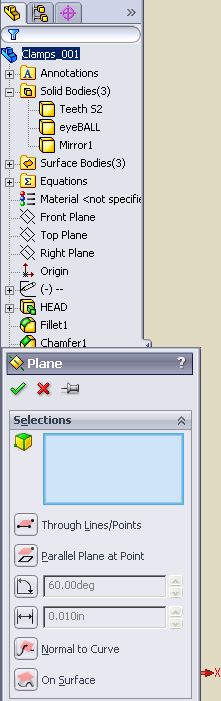

Anyone notice if you try to zoom with the mouse wheel, just to the right of the feature tree area (within a part), it thinks there is a tree hidden in space and wants to scroll it; and not zoom?
This drives me crazy.
Must be a bug.

Try turning off the
Show Transparent Feature Manager in graphics area option in System Options > Feature Manager. Since you can detach or dock the Property Manager in 5 areas, I use it typically docked on the lower left corner of the screen or split the manager tree if needed.
If there is only the property manager shown in the Manager Area and it is not split, if you click the feature manager while the Property Manager is active it will display on screen.
I think the option I'm referring to for Transparent Tree may only affect whether a background is shown behind the tree and not whether it will appear or not. Give it a try and see if that helps. There is also a shortcut "C" to collapse the tree and show scroll bars on the side and bottom which helps navigating a large tree in the graphics area.
If the tree extends past the screen and tree is expanded there is a scroll bar and I think SolidWorks reserves that space from zooming so there is a smooth transition between collapsed and expanded states for better tree navigation. Download zip file to see attached images. The image with the dashed grey line only has problems for trees that are taller than display area height.

Picture Showing Docked Property Manager
If the Property Manager is Dragged away from the tabs there will be docking rectangles displayed that allow it to be attached to window or made into Floating Toolbar that can be collapsed.
As long as it's not in the default location next to Feature Manager as second tab, the on screen tree that may be causing the Zoom Problem can be prevented from popping out.
I tested the Split Manager that I use to see Configuration and Feature Managers at the same time and that forces the Tree to show on screen automatically so scrap that idea from my previous post.
