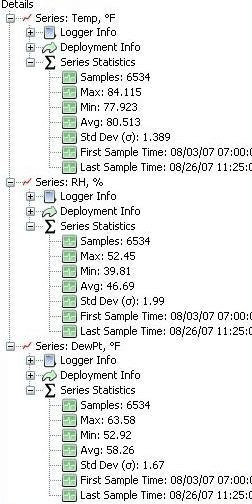

I built a fourplex in the tropics and I put my money where my mouth was. I sealed the damn attics.
No when you seal them, you are supposed to condition them. Well I cheated, did not condition the attic void, and I kept an eye on them to see how they were working.
Conclusion
Attic space, averaged in the top right hand corner of ASHRAE's comfort zone.
My attic, August 2007, the big dip in RH was me pre-chilling the place as Hurricane Dean Approached, the spike back up was the 8 hour power failure during storm. The drop in temp and RH is due to increased heat transfer through sheet rock ceiling to conditioned space below. Insualtion is on top of roof deck not at ceiling plane.
It averaged at 80.5F and 47% RH
I have since stored some valuable items up there and as insurance I added about 30 CFM of air, temperature averages 79, RH in the 40s. The other three units do not even have any deliberate conditioned air supplied to them. Been 3 years now, no problems.
