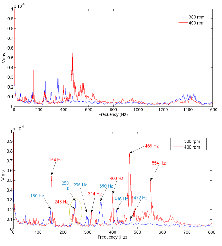

I did several tests as follows. The PM motor was driven by the DC machine at 300rpm (or 300/60=5Hz) and 400rpm (or 400/60=6.67Hz). Measured results are given in attached image. It looks to me that most vibration peaks found at frequencies much higher than the fundamental 1X running speed. Besides, vibration peaks are found around 250Hz on both 300rpm and 400rpm vibration spectrum, which, in other words, these peaks do not depend on rotating speed. Would you please help me to explain the results?

[IMG]http://img.photobucket.com/albums/v608/zhaopian/DrivenByDCMotor.png[/IMG]

Directionality = comparison between directions, usually horizontal and vertical measurements on a horizontal machine.  If vib at a given frequency is much higher in horizontal direction than vertical, we often suspect resonance in the horizontal plane at that frequency.
How may poles does the PM machine have?

The PM motor has 12 slots and 10 poles (or 5 pole-pairs). By the way, which "velocity" do you mean? The Y-axis of results shown in my previous post were not scaled to the actual units.

At 300 rpm (5hz), a 10-pole machine generates 25hz voltage and current.   (25 hz is frequency of output of the generator).  The associated forces vary at twice the electrical frequency (since magnetic force is unidirectional varying between 0 and max twice per electrical cycle) which would be 50hz.
The pattern of harmonics of 50hz are seen in the blue (300cpm) spectrum: 150, 200 (not labeled), 250, 300 (labeled 296?), 350.  These are very likely electrical.
I don't quite understand the 416 and 472.  Could be lots of things.  Do you happen to have the bearing part numbers?
You lost me when you started talking about hammer.  I assume these are running vibration tests, not impact tests. Where does the hammer fit in?

First of all I wish to apologize for mentioning "Impact Hammer" in my last post in this thread. I did carry out several Impact Hammer tests (please refer http://www.eng-tips.com/viewthread.cfm?qid=252742), but they are nothing to do with the test mentioned in this thread.
The test results shown in my previous post were obtained based on the test setup and procedure as described in Case-1 (please refer to my first post of this thread), except that now the DC machine runs at 300rpm and 400rpm. As the terminals of the PM motor (which is driven by the DC machine) are left open, I suppose the PM motor does not produce any current. Unfortunately, I do not have the bearing part numbers. As the DC machine is a brushed DC shunt wound machine, do you think the brush/commutator assembly will contribute to the vibration spectrum shown above?
By the way, is there any vibration source that does not rely on motor speed (those spikes marked by YELLOW circle in the results)?
