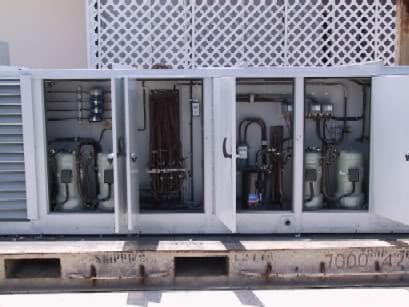

this one was made in Calgary
4 trane scrolls on the big coil get air down to about 52F
copeland is connected to an additional evaporator and condesner in series down streams,pulls the air down to about 50 on a dehu call, with fan heat it blows about 65F dry air
