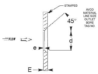

Unfortunetaly several square edge orifice plates are installed reverse. (upstream / downstream), so the sharp edge is upstream. What is the effect we can expect, less delta P? What kind of extra unaccuracy we can expect?

The literature uses numbers between 24% and 28% low.  I've done some experiments that support that range and have had a couple of meter stations over the years that were in that range of error.
Of course, anyone who puts a plate in backwards might be prone to other errors (like not checking for a nicked edge, not getting the seal on righ, damaging the seal, etc.) and the station may actually have a higher cumulative error.

I had a guy install both plates backward on a 12 MMCF/d well with two 6-inch meter tubes.  3 months later when the problem was found we got a pretty big sales adjustment.  I went to a meeting with my boss and the head of gas measurement a few days later and this came up.  The measurement ditz said "how could any idiot put a plate in backwards?" so I drew a cross-section of a plate on the board and asked her to tell me what the flow direction was.  She said "left to right, the bevel makes it easier for the gas to enter the hole".  My boss said "they call it 'square edged orifice measurement' for a reason".  Even "measurement professionals" with Engineering degrees can get it wrong.

I try the formula %DQ = -18.93 + 12.91b - 34.04 (E/Dnom) – 8.900 (e/E) + 13.64 (e/E)2  but it leads to crazy figures. (Morrow and George have proposed the following correlation for a backwards-facing orifice plate to estimate the percentage measurement error as a function of the beta ratio, b, plate thickness to meter tube diameter ratio, E/Dnom, and bore thickness to plate thickness ratio, e/E.)
To my unnderstanding it is the factor e/E which blows up.
Has anybody an positive experienced formula?

Indeed, the fact is we all know how to install to stamp and mark orifices, At this moment we have several pieces installed wrongly. They have to sit there the next 2 years, what I have to find out is how much deviation we have an if it is lineair over the range. At this moment I expect -20%.

Thans Danw2, I have contacted the authors and been helped very kindly. I have put the figures in a spreadsheet; the deviation is between 11 and 15% for orifices between 2 and 10".
