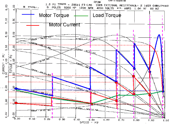

Attached are motor performance curves.
The one thing I dont understand on the attached speed vs torque curves is how the maximum torque is less for 100% external resistance than it is for 10% external resistance.  I understood that all above equations kept the maximum torque the same, and only shifted the slip point where it occured.  Why then on the attached curves is the greater amount of external resistance (100%) have the lowest avaliable torque?

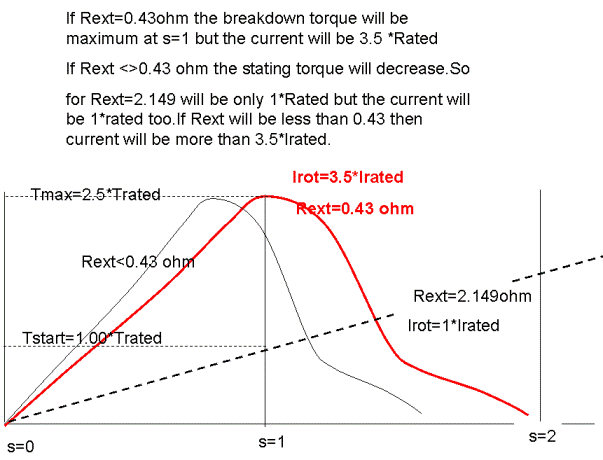

If Rext will increase up to 0.43 ohm the start torque will grow up to the maximum[2.5*Trated].Further the start torque will decrease as Rext will increase. See the sketch:

Fist of all you are right:-the breakdown torque does not change with Rext. Only sTmax is changing with Rrotor. But what you do need is the Starting Torque and this will be equal to Breakdown Torque only in the case that sTmax=1.
I don't intend to demonstrate this but I jump directly to:
sTmax=Rtotref/sqrt (Rs^2+ (Xs+Xrotref)^2)
where  Rtotref=(Rrotorwinding+Rext) referred to stator [R'r]
            Xrotref=Rotor reactance referred to stator.[X'r]
I think the rotor voltage 3370 V is the secondary voltage in rotor open circuit when the primary [the stator] is supplied by rated voltage[4000 V].So the voltage drop on the stator impedance may be neglected and the rotor voltage drop is zero.
If we'll take krs= Erotor /Es=3370/4000=0.8425 then I'rotrated=875*krs and
Rtotref= (Rrotorwinding+Rext)/krs^2
Xrotref=Xrot/krs^2
The starting torque=break down torque if
 Rtotref= sqrt(Rs^2+(Xs+Xrotref)^2)
If Rs=0.0192 ohm and Xs= 14*Rs =0.2688 ohm and Xrot=13* Rrotorwinding=14*.02=0.26 ohm
Xrotref=0.26/.8425^2=0.3663
Rrotref=sqrt(0.0192^2+(0.2688+.3663)^2)=0.6354
Rrot=Rrotref*krs^2=0.45 ohm
Rext=Rrot-Rrotwinding=0.45-.02=0.43 ohm.
The factor [13or14] to multiply the Rs or Rrotor in order to get the reactance[ Xs and Xrot] it is resulted from recalculating process of  rated torque and breakdown torque.
The calculation was based on Steinmetz diagram.
In this calculation the Io[no load current] was neglected.

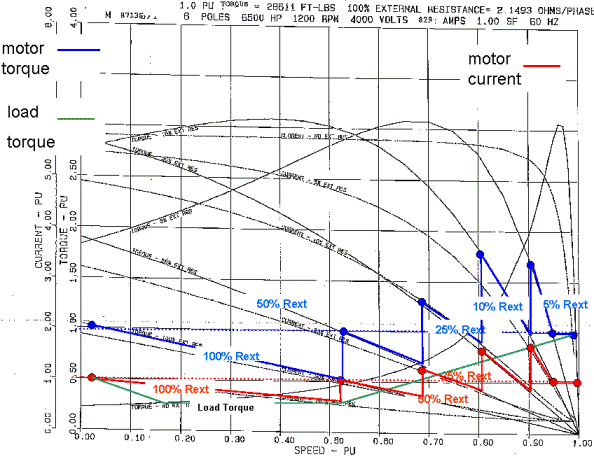

It depends upon the load required torque curve .Usually at the start it is less than 1/2 of rated and it goes down a while with rpm increasing and approximately from 1/2 rated rpm goes straight to the rated torque.
In these conditions in order to maintain the motor torque curve above the load curve you have to reduce the Rext as follows:
At rpm[p.u.]         Rext    Load Torque[p.u.]   Motor Torque[p.u.]   current [p.u.]
    0                     100%              0.5                           1                            1
 0.5                      50%              0.3                     0.5 jump to 1            0.5-1
 0.68                    25%               0.5                        0.7-1.3                 0.7-1.2
  0.8                     10%               0.7                        0.8-1.8                  0.8-1.7
 0.9                      5%                 0.8                        1-1.7                     0.8-1.7
 0.95                     0%                0.9                           1                            1

We finally started this motor, and were very sucessful with its start.  The complete sarting time for the Rheostat/Motor combination ended up being 42s which was a factor of how long the Rheostat taks to step through its varying resistance levels.
Full load current on this motor is 829A and when starting the highest reading I saw on the motor was 1060A right at the begining of the start.  This current was only for a brief amount of time and then quickly dropped down to below full load (829A) for the remainder of the start.  To me this looked very good and the relay indicated that only 1% of the motor thermal capacity was used during the start.  This would almost indicate to me that this motor could be started time and time again (But obviously we would never attempt)
At first this starting time of 42s seemed long to me but after seeing the motor start several times it appears to work great.  Is this long starting time typical for this type of application and are there any drawbacks due to this?  I have heard of another location with a similar size motor and arrangement that has a starting time of 20s or so.

LionelHutz is right. I think that the load torque curve as I drew it in the above post is very "optimistic". Actually, the load torque curve is located higher so the acceleration torque [Ta]
[equal to the difference between Motor Torque and Load Torque] is small. Then the acceleration time [ta] will be elevated since ta=Wk^2*Delta N/308/Ta.[Ta small= ta big].
If, for instance, you'll change the Rext from 100% to 50% at 25%velocity [300 rpm] instead of 50% [600 rpm] and further you'll change to 25%Rext at 50%velocity [600 rpm], to 10% at 68%velocity, to 5%Rext at 80% and to 0 % at 90%, you'll get only 12.5 seconds total acceleration time.
But, in this arrangement the current will be from 1.5 to 5.5[p.u].If the stall time [state by manufacturer] would be 10-13 second, this could be fair.

Your numbers seemed odd to me unless you just posted them differently. Ideally, you always operate the motor to the right of the breakdown torque. If so, the current and torque start out high on each step and drop as the motor accelerates. Then, at the next step, the torque and current jump up again and drop off again as the motor accelerates to the next speed.
Like from 0 -> 50% speed I'd expect
torque to go 100% -> 50%

Wk^2=  31750  Lbft² [rotor+load] ; Delta N= Delta N[p.u.]*1200 rpm. Ta=(av.motorTq[p.u.]-av.loadTq[p.u.])*Tn
Where Tn[rated Torque]= 29611 lb.ft .
I took the Rext switching rpm deliberately at 50%-600 rpm- [first time] and 25%-300 rpm [second time] and so on.
The Load Torque Curve is calculated so that total ta=40 sec. [in first Rext switching proposal].
Here is the result table :
Rext            Delta N                            average         average
switching       [p.u.]       Rext.[%]    loadTq[pu]   motorTq[pu]   ta[sec]
rpm[p.u.]
 0-0.25            0.25            100%             0.775             0.9           8.355
0.25-0.50        0.25              50%             0.565             1.25         1.524
0.50-0.68        0.18              25%             0.725             1.3           1.308
0.68-0.8          0.12              10%             0.825             1.9           0.466
0.8-0.9            0.10                5%             0.875             2.2           0.315
0.9-0.98          0.08                0%             0.95               1.8           0.393
                                                                                 Total sec.=   12.363
The attached sketch may clear more the explanation.

How can the load torque be different from the motor torque? The motor will accelerate as fast as the torque that it produces allows.
RE: Wound rotor motor parameters
rhatcher - the load torque is the torque the motor must produce just to keep the load turning. The motor torque is the torque the motor produces. The difference between the motor torque and the load torque is the accelerating torque.
Yes, the curves help and that is exactly the type of acceleration that occurs. I'll just note that you want to avoid a situation like the last step where there is a large current and torque peak. You would try to accelerate closer to full load before shorting.
I just realized the last line in the last post should have read "This is not possible without a feedback loop".
Thanks LionelHutz, I was having a "no brain" moment when I pondered that question. My thoughts were: "How can the torque output of the motor not equal the torque applied to the load?" Your explanation of what 7anoter4 meant by "load torque" is the textbook definition of that term and I agree that is what he meant.
That being said, the shape of that torque curve is unusual.  Definitely not variable torque in the normal sense and also not quite constant torque. Do you think that it is a measured value from a load cell or a calculated value based on load intertia, motor toqrue, and acceleration time?
Also, I am thinking that the OP's description of the resistor(s) as a rheostat implies that it is continually adjustable from 0-100%. That would imply a curved acceleration rate based on the rate that the rheostat changes rather than the steps that the graph shows. If so, it would allow the OP a lot of flexibilty in determining acceleration time.
