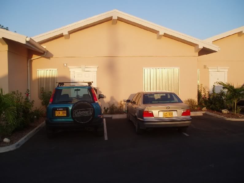

If you seal the attic and insulate the roof deck and any gable walls, the building will tend to be very dry, and I doubt the attic gets much hotter than 80F.
A white metal roof is a no brainer, keeps the heat out, reflects it away.
Driest condos in the caribbean (hurricane panels up for Hurricane Dean)
sealed unconditioned attic averaged 80.5F and 47% RH in Aug 2007

RE: Island Life
if anyone cares, the attic temperature peaked after sunset. Basically some thermal mass releasing heat and ceiling mounted lights were turned on. Attic insualted at roof deck tends to trap heat
The roof is about R7, I figure it is more effective then R30 at the ceiling plane with a vented attic.
