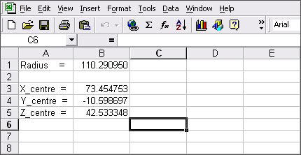

GIVEN: X-Y-Z coordinates of 3 points in 3D space.  FIND:  Radius of circle on those 3 points & Circle center co-ordinatesBookmark:
Question: Can someone provide a mathematical step by step procedure to calculate and determine a circle radius and the center point coordinates from three GIVEN 3D points with X-Y-Z coordinates?
 - I have searched the web extensively, and found lots of proposed solutions, but my college math is quite rusty and after several days, I still can not come up with the correct detailed solution.   I can do this easily from three points in 2D, in Excel using three simultaneous equations with TWO variables (i.e. find circle center @ h, j).   But I can't get it to work in 3D with a similar spreadsheet approach with THREE variables (i.e. find circle center @ h-j-k).  Seems I keep going in mathematical circles (no pun intended) with a modified Excel approach with the three quadratic equations.
 - Is it possible to solve this mathematically with (3) simultaneous quadratic equations?  Or do I need a 4th equation, determinates, etc?.  Seems when I try the double elimination (or substitution) of variables approach, I keep coming up with unsolvable, or meaningless equations.   With as much time as we have spent on this problem, we would be happy to compensate someone for their time to solve this for us.
 - We have several drawings with bent pipes in 3D where we have only THREE 3D points given to us.   We need to be able to determine the TRUE bend radius of the pipes.  These are special alloy pipes @ $25k each, so we want to be sure we have the correct 2D bend radius before we bend them.  I'd prefer an approach that could be put into a spreadsheet to make reiterative calcs go quickly.   I'd prefer to have a detailed step-by-step solution vs. being directed to one of the web solutions.  I have seen most of them, and still am stuck on this.

Have you tried to structure the three 3D distance equations from the center, and have Excel solve for when all 3 distances are equal?  You don't, at this point, really care what the equation of the sphere looks like, you simply need to find the center.
However, as with GPS, you could get a poor geometrical dilution of precision, particularly if the 3 points are clustered within a small portion of the sphere.

RE: Find circle radius & circle center in 3D from (3) XYZ pts
Ha, the solver method works very quickly, took 2 minutes to type it in.
    X    Y    Z
1    17    300    4
2    -99    56    2
3    8    5    -33
Centre    20.6    148.6    14.4
Radius    151.8
Cheers
Greg Locock
SIG:Please see FAQ731-376: Eng-Tips.com Forum Policies for tips on how to make the best use of Eng-Tips.

Finding the centre and radius of the circumscribed circle of a triangle (ABC) is something I first did in the mid-1980s — in BASIC, I'm retired now but I've still got the notes written at the time.  The normal form of the plane equation wasn't used — just the direction cosines of the axis system that the three points are in. The diameter of the circle that fits the corners of the triangle is the length of any side divided by the sine of its opposite angle; the centre of the circle is found by solving one more triangle.
The following code is modified BASIC; if it's pasted into an Excel VBA macro it will run — it is basic stuff in more ways than one. I'm sure there are slicker ways of doing this task, but I've used direction cosines; the code has been run with various values (and signs) for the three points — and has outputted the correct (so far...) radius and radius centre coordinate each time. (I've had it checked against a CATIA model)
I've posted the code because an original requirement was for a solution that could be pasted in and run.

                    Cells(1, 1) = "Radius    =": Cells(1, 2) = R
                    Cells(3, 1) = "X_centre  =": Cells(3, 2) = X_centre
                    Cells(4, 1) = "Y_centre  =": Cells(4, 2) = Y_centre
                    Cells(5, 1) = "Z_centre  =": Cells(5, 2) = Z_centre

After some fumbling around, I was able to get Kapitan's Code to work (This is the first time I've used VB)
Just as he suggested, it was pasted into a Macro in VB and then Run.  In order to use some other 3D points in space, I invoked the Macro, then used "Step Into" to edit in some different values; Ran it, noted the new values, then went back and compared to a SW drawing. All looked OK. Is this the "normal" way to do this?
(Phew)
Got the IP.xls to work.
Entered some values in a new Sheet and compared to SW drawing...accurate to 4 plcs.
"To get the other results select 4 adjacent columns and 1 or 2 rows, with the function entered in the top left cell, press F2 to enter edit mode, then press ctrl-shift-enter."
This part didnt seem to work for me. (maybe something I don't understand about the array function)
Instead of "select 4 adjacent columns", I selected the cell containing =ArcCenT2IP(A1:C1, A3:C3, A2:C2), then drag-selected 3 more columns to the right, but only 1 row, then did the F2 ctrl-shift-enter thing, and it filled the cells with the correct values for a 2pt circle with tangent lines intersecting at the 3rd pt.
For the next row down, I did the same thing, and it filled in the values for the 3pt circle situation
Doug, Kapitan and Greg, Thanks so much for the help on this topic and your patience with an Excel novice.

Doug,
 - Thanks again for postings.  Most helpful.
 - By any chance do you have a couple of related formulas?
1) After determining the circle radius and center point, do you have an Excel solution to determine the coordinates of any other point on the circle given any one of the X-Y-Z coordinates of the unknown point, OR given the arc angle from another known point on the circle?
2) Knowing the coordinates of 2 points in 3D (i.e. a line in 3D), an Excel method to determine the coordinates of any other point on the line by just plugging in a distance along the line from one of the two known points?  This is pretty simple with the distance formula. If you don't already have this written, I can write it.  I thought I'd check first to see if you already have one done in Excel.
Thanks again,
Mike P.
Mike - I don't have those functions right now, although the ptor (polar to rectangular) and rtop (rectangular to polar) functions would go most of the way to doing the calculation.
My plan is to split out the interpolation part of the IP spreadsheet, and add in additional geometric functions and line plotting functions, and make it a complete geometric tool-box, but I don't know when I'll get round to doing that.
Doug Jenkins
