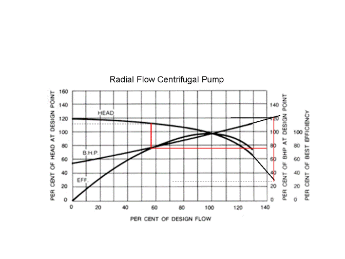

All good comments above, and certainly correct that the behavior for your pump is increasing bhp requirement with increasing flow.  It is the case for most but not all pumps commonly called centrifugal.  It is the case for radial flow pumps and mixed flow pumps over portions of the range.
Your expectation of different behavior may come from experience with axial flow pumps which behave the opposite (decreasing bhp with increasing flow). Axial flow pumps are often used in high-flow low-dp applications - we have them in our power plant circ water pumps.

I agree with electricpete. If the motor drives an axial centrifugal pump following the fig.7 of the http://www.gouldspumps.com/cpf_0009.html indicated in the above FAQ
then closing the pump valve [throttling] actually we increase the Head in a way more than the flow and pump efficiency decreases and then the pump required bhp will increase too.
From Fig.no. 7 if the Head [Total Dynamic Head] will grow-up to 245%, efficiency will decrease to 29% level and the flow to 21%.
From http://www.gouldspumps.com/cpf_0004.html:
bhp=Q*TDH*Sp.Gr./3960/Pump Efficiency
Since Sp.Gr does not change [the same temperature and the same liquid] :
bhp%=Q%*TDH%/Efficiency%=0.21*2.45/.29= 1.77[177%]
The motor required current will be  I=bhp*.746*1000/voltage/motor efficiency/pf/sqrt(3)
We don't expect dramatic change in pf and motor efficiency in the limits of 100% up to 177%
Then I%=bhp%
So, if I=8A is for rated flow [100%] then I= 14 A [175%] will be for only 21% flow.

I am sorry, I didn't remark your post of 27.05.09 8:18 and I thought the flow was the "load" .If the load is the backpressure, in this case the pump is a radial flow pump and from the Fig no. 5[from the link of the electricpete FAQ]  an explanation may be as following:
If the Head%=backpressure% then if  backpressure[5psi]%= 27.5% and  backpressure[20psi]%=4*27.5= 110%
From Fig.5 diagram:
If the Head would 110% then bhp=75% if the head is 27.5%  then bhp=120%.
If bhp%=I% then if 8A= 75% then 14 A is 120%.Other combination may be possible also.
By the way,  in your post of 28.05.09 22:40 you said [quote:] "flow rate, pressure and voltage are all the same" .I  think in no way the flow and the pressure could  be the same for 5psi and for 20psi backpressure.
