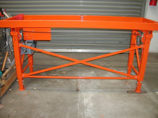

I've built a stand comprised of four screw jacks ganged together.  (Teach me not to wander from the electrical reservation!)
[unloaded]
I did meticulous empirical testing to discover how much force needed on a specific moment arm was required for one of these jacks to lift X pounds.
I rounded everything up and used the next size up of everything.
It is driven by a gear drive motor @ 60Hz that is rated at 10.15Nm @ 158RPM (250W)
[motor plate]
It goes up and down 'just great' taking about 2 minutes... Unless the design load is on it!  The load is 3,000lbs.
My test load is 1.60 tons(3,200lbs) accurately measured on commercial scales.

The motor starts very, (very), hard then continues raising the load up the 18in distance while drawing 550W.  Near the top ~15 inches it really starts bogging.  Hitting 900W and and pulling 8+amps into the 120V voltage-doubling VFD just before stalling entirely.

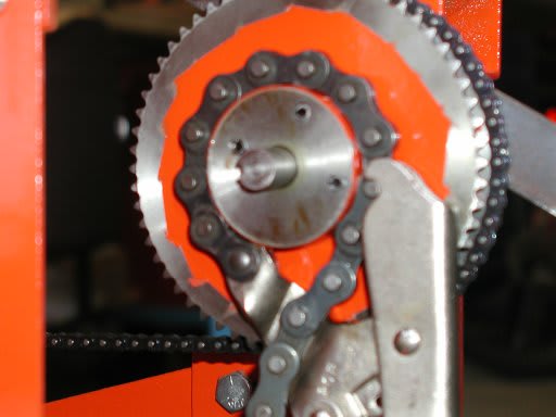

First thought was that the four jacks are binding up tight and just bringing everything to screeching halt.   A plan was hatched to test this theory.  A sprocket had a nut welded to it and a bending-bar torque wrench was used to continue lifting after a stalling point with the motor was reached.  The nut/sprocket was mounted onto the motor's shaft.
You can just see the nut/sprocket on the end of the motor shaft - the second sprocket.
[oblique]
[Larger image] http://www.box.net/shared/static/okpj9legnb.jpg
No hard binding was detected. It just takes 19.5~20.0ft-lbs to continue raising the load. It continues up smoothly with no hitches at the 20ft-lbs. By hand, slow or fast, the 20 is constant.
This looks to me like (20 x 158)/5252 = 0.6hp ~ 450W which is pretty much being shown by what I'm seeing.

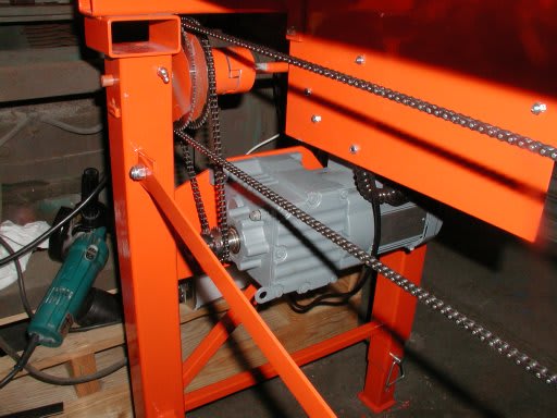

Presently the gear train includes the motor and its gear box. This is followed with a 19T sprocket driving a 60T sprocket.  Using two other 60T sprockets the power is transmitted to the opposite side.
Their is no hurry as the system takes about 2 minutes to raise unloaded, five minutes presents no operational issues.  My thought is to increase the ratio further.
[above gear train]
I'm looking for suggestions.  Something that will fit the present geometry without major surgery.  Something like 3:1 maybe.  I'm seeing no suitable way without a bunch of changes.

It looks like you're applying a fairly serious chain pull to what I think is the jacks' input shaft, and it doesn't have the bearings for it, even neglecting where the sprocket overhang multiplies the moment.
I'd be inclined to drive the intermediate shaft, and support it in its own set of bearings, e.g. flange bearings or hanger bearings.  The intermediate shaft could probably be a little fatter, to better resist bending from the sprocket loads.  That's the second best part about Lovejoy couplings; within a series, jaws with different bores will interchange.

Without changing much else, you could maybe go a couple teeth smaller on the gearbox sprocket and a couple teeth bigger on the first driven sprocket.  That might help some.
I agree with Willie; better alignment will help more.
The behavior suggests a dynamic alignment problem.
Right now, the front legs are laterally braced in only one direction.
E.g. you've got X bracing between the 'rear' legs in a vertical plane... but you might add X bracing, or something structurally equivalent, in a horizontal plane, to prevent the 'front' legs from going bowlegged or knock-kneed.

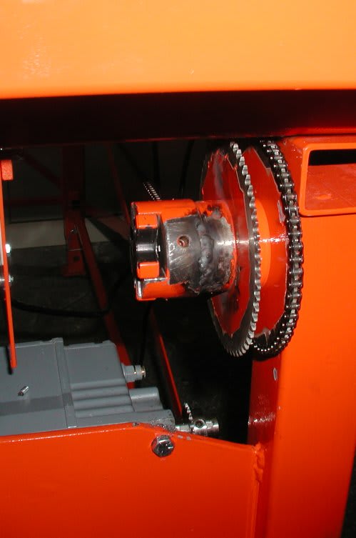

During further testing the first driven sprocket was found turning while the secondary sprocket feeding the left side wasn't!  It's hard to find sprockets with key-ways for 1/2" shafts.  So I drilled the two gears and tied them together with roll pins.
Of course you know what happened next.. Both the tied together sprockets now spun on the unkeyed shaft.
The Lovejoys luckily are keyed. By tying the two sprockets to the Lovejoy with a TIG welder the sprockets are now essentially keyed.  They do not slip now.

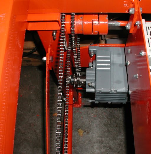

To drop the motor load I came up with an interposing gear reduction. A 20T/72T pair of sprockets welded coaxially.
Held on a support plate, on a precision shoulder bolt riding on two needle bearings.  The motor gearbox runs the gear reduction large gear and the small gear feeds the original driven gear.  The motor now runs at 205W meaning it isn't even fully loaded.  The down side, and it isn't much of one, is that a cycle takes 9 minutes.
Everything seems OK except for one troubling detail.
Look closely at the above picture.  Look at the chain.  Look at what some of the links are doing.  If you let the chain run thru your fingers it feels lumpy in various places. This is brand new chain. What causes that? It's only on that chain.  The one with the highest load.. I have a bad feeling.. cry

It's normal for new roller chain to be a little stiff.
That said, this would be a good time to drag out the engineering section of the catalog and review your sizing calculations.

Use taperlock sprockets. They are available with keyways for 1/2" shafts

What happens if you overload chain? Does it deform or just break.  I was thinking the rollers could be bent and that would cause what I'm seeing.  Especially since it only appeared after that particular piece of chain had its load increased by the gear-down.
Keith Cress
RE: Ratio issues
The roller chain size that I think you're using is of simplified construction.  I'd expect the pins to be the weak link.  They will bend a little before they snap.
I keep forgetting you're a sparky.  That's a compliment, but it also means you probably haven't read the engineering section of the roller chain catalog, what with chains being so simple and all..
So, okay, backyard engineering analysis: Since you've at least doubled the tension on that strand, and it's getting wonky, it would make sense to substitute a larger chain size, or double or triple up on that pass, i.e. duplex or triplex sprockets and chain, or just multiple sprockets pinned together.  Don't try to get fancy and stagger the teeth; just line them up nice.

I decided to re-do the math for a sanity check on the tension expected to be applied to the chain.
If we recall the torque wrench test. 20ft-lbs were required at the original motor gear box drive gear.  It's 19T and has a radius of about 0.775".
0.775" x (1ft/12")= 0.065ft diameter.
To transmit 20ft-lbs on a moment arm of 0.065ft we would need a tension on the loaded side of:
20ft-lbs/0.065ft = 309lbs.....bugeyedbomb
Is this too much for my chain rated at a working load of 114lbs? flush
Man!  That calls for a chain of at least ANSI 40!!
What a disaster..  banghead
Keith Cress
RE: Ratio issues
Yeah, that's what I meant by "fairly serious chain pull ".
Industrial drive design tables are conservative; you might get away with a slightly smaller chain size.  I wouldn't try; the difference is less than a warranty claim.
Mechanical education can get expensive, but so far you got off easy; only your wallet has been injured.

Keith, any mom-n-pop machine shop will have Dumore keyway broaches. That would have solved your keyway dilemma. If not, they are reasonably cheap to purchase and only require a small press to use.
It is possible you will still lose it with the TIG weld...
